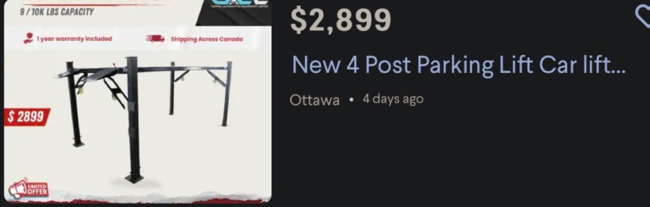

Four post lifts are not as expensive as one might think. IIRC I paid about $2500 (pre COVID).
Takes about 3 hours to install.
pre-covid, I've been looking since, nothing used, anything new is 10g or better now with the 2500lb center rolling jack! $2500 I wish!
I'd check with your local tool houses...or wholesale equipment suppliers...
Shit...even crackbook MP, I've seen them.
Some yokel here in Kelowna is trying to flog an inground hydraulic post...for the princely sum of 200 bucks.
He can keep it...I imagine the prep to install it would be insanely spendy

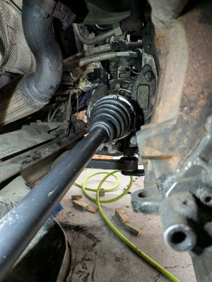

Next up are the axles and new timing belt. Then I can put the front end back on the ground and do the rear suspension.

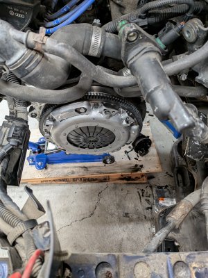

Something is amiss with the new clutch.
Got it all bolted back in.
When I was reinstalling the axle drive flanges in the transmission I put the transmission into 5th gear thinking that would give the most resistance so I could torque the cap screws down.
I was able to turn the drive flanges with the ratchet which seemed odd to me. I expected it to be locked solid.

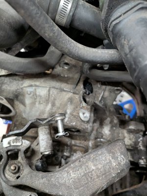

I pulled the slave cylinder thinking maybe it was partially disengaging the clutch. No difference.
There is free play on the clutch fork so it would seem the pressure plate is fully released.
Only thing I can think is that maybe I installed the friction disk facing the wrong way.

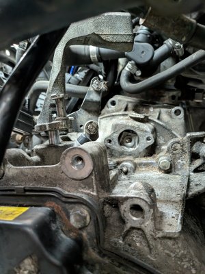

Usually they have "flywheel side" stamped on them.
Does actuating the clutch feel normal?

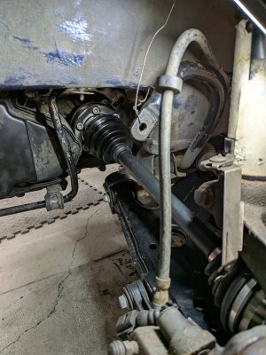

Thinking about this more I think what's happening is that I'm turning the differential. There aren't any axles connected so I don't have an easy way to stop the other side from turning.
I'll put the driver side axle in tomorrow. That way I can stick a screwdriver into the brake rotor slot to stop that side from turning while I try and turn the other side.
I think maybe low gear also, you put it in low gear when parking a manual trany, which helps to prevent rolling. Not having the other side of the diff locked down, will/likely allow it just to spin and not even let the torquing get to the trany.
Right, my thinking was muddled on the first vs. fifth gear thing. I was thinking about when push starting a car you put it in the highest gear. Doh!
