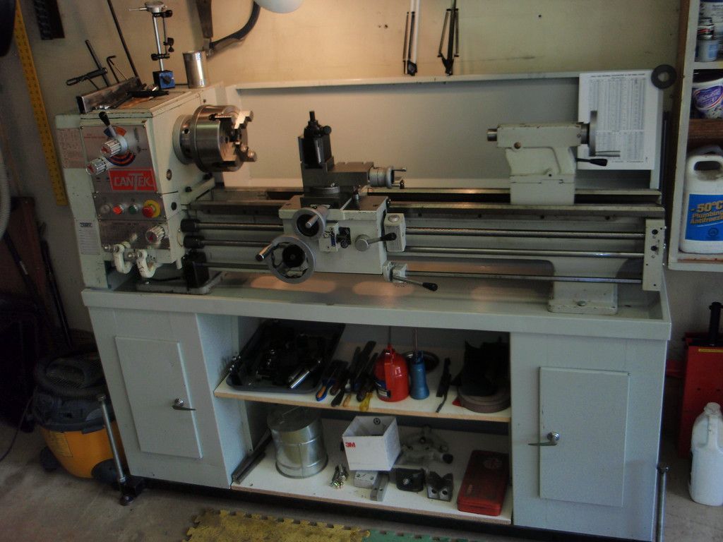

That looks like a newer one as it has the enclosed gear box instead of the Norton style on the previous lathe.
I prefer the fully enclosed gearbox. My previous lathe had a Norton style, they require frequent lubrication by hand . The fully enclosed one runs in an oil bath.
The 2 protruding handles on the left are for the Norton gearbox.

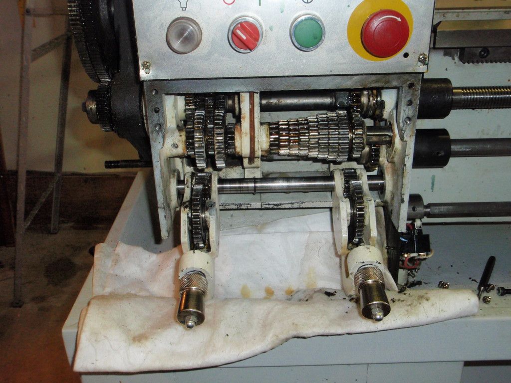

This is what's inside.
You normally would lube a Norton style each time you use the machine by removing this plug and squirting oil into the space above the gearbox. The oil drips down through holes in the casting onto the gears.

One of the key differences between the King Canada 1236 and the Busy Bee one is the gearbox. King uses a Norton, Busy bee one is fully enclosed. If everything else was equal I would choose the fully enclosed.

On the newer machine you can see the oil level sight glass for the gearbox here.
