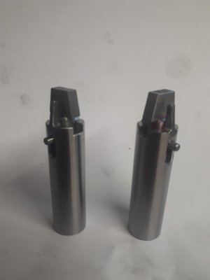

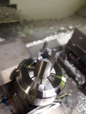

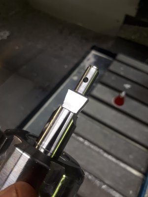

The millturn fixturing method. I use this a lot at work for special fixture and gauge pins. I don't generally use the spindex, but my er32 collet blocks (hex or square), as it also allows me to stand it up and hit that 5th side.
I have used a spindexer as well, but prefer the ER blocks when I can. They each have their merits, but overall the Millturn method like this is an awesome arrow to have in your quiver.
