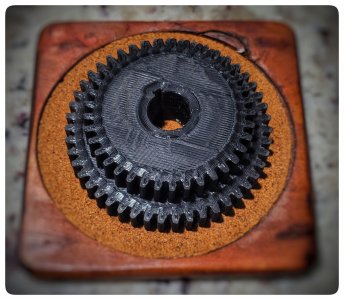

Looking for a 127/100 tooth gear so I can thread metric. Is anyone interested in 3D printing one? I can order from fleabay but would rather support you guys.
Here's a link to a few choices, I went with the 47/37 because I (think) the door won't close with the 127/100 and the gear ratio is so close it will never matter.
I read that the door won't close w/ the 127/100 gear, too. Unsure how much of an issue that is for me.
47/37 is loaded into the printer. When it's finished it's yours if you'd like it
I believe the one I printed from there for mine I bored out and put a brass bushing in so you may need to do that if that's ok? I'll see what it measures off the printer I can't remember if I did it because it needed to be larger, or I just wanted a bushing in there like the ones from ebay
Centre bore is around .545 so just have to enlarge is slightly to I believe they are 9/16 or bush it.
