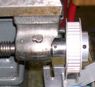

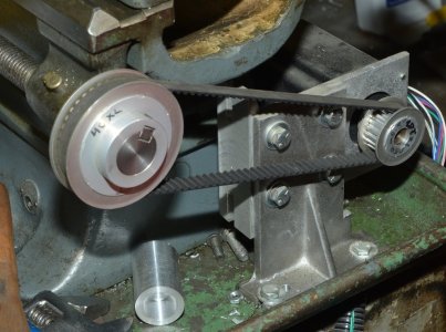

I bought a replacement spindle from him 'cause 4 of my back gear teeth were broken. It's not a terrible job to replace. Keep track of how many turns the adjustment screw on the back gear ass'y is turned out. As I noted in the link in post 13, I changed the drive to a serpentine belt at the same time.

Popped the DIY belt guard off for a closer look and the weird motor mount may also have been done for clearance between the belt guard and the back gear lever. With how wobbly that whole assembly is I definitely plan to see if it can be mounted differently (would likely need a different length belt).
