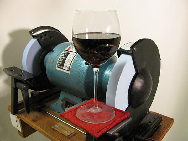

How much pressure are you putting on the tool? Is the wheel a good quality one? I got Norton white wheels for the 8" and I can touch up the metal lathe .040" parting blade in pretty controlled way. But those white wheels are soft and I don't think they would last long for 'general grinding' - odd jobs around the shop shaping cold-rolled steel. I kept my 6" grinder for that.
