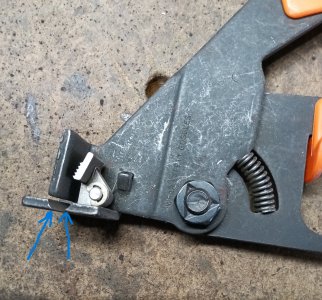

You can see the cutting mechanism on the bent jaws quite clearly, in the picture. Look forward of the ratchet pawl axle, and you can see the matching rounded ground surfaces that do the cutting. The cutting edge runs more or less parallel with the hand grip, in use.
I mean, I don't want to beat this to death, but all I see is a tapered groove with a slot between those tangs, not a cutting mechanism.
Those two points I highlighted, move closer and farther away from each other, while the ratchet draws the strap tighter. They are at a right angle to the plane that the ratchet works at, When it is as tight as wanted, you squeeze down hard, and it cuts with the edges I have highlighted. Simple, and few moving parts.
Truly, it is hard for me to understand that you cannot 'see' that !
You said earlier, that you only saw two stamped parts. Yes. You have to se how they were bent,to see how it works.

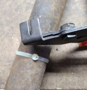

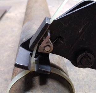

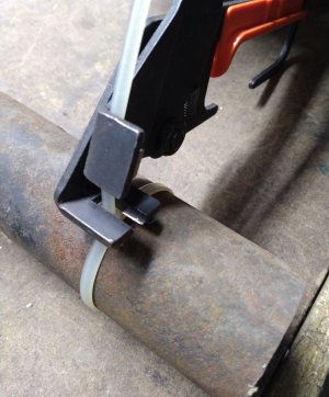

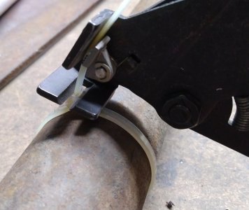

And here, I hope, is the last word on my fool tool.
I wrapped a zip tie around a piece of pipe to illustrate how it works. I think that the pictures show that the notched bottom plate does not move, is not sharp, and plays no role in cutting the tie. I did find, however, that twisting the tool after tightening the tie works just fine, as the tie bears against the bottom plate and Is severed flush with the ratchet head of the tie.
So, I have a manual tool that cuts--sort of.
