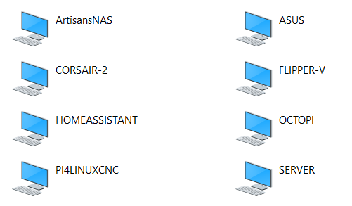

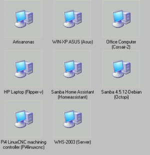

Just in case someone might know the answer to this. Here's my ARTISAN workgroup view from my old WIN-XP PC.
The Samba Home Assistant, Pi4 LinuxCNC and Octopi are all Raspberry Pi computers running Linux. The interesting (or maybe not) is the Flipper-v which runs WIN-10 and Corsair-2 which runs WIN-10.

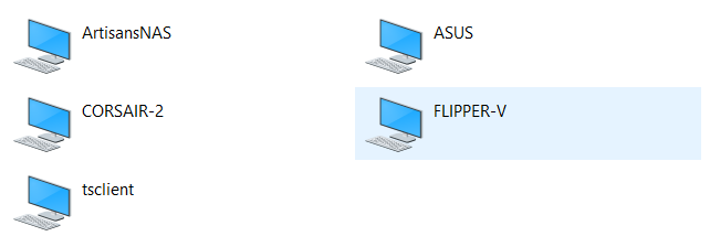

And then we have the WIN-10 Corsair. Oh my... what happened to the Raspberry Pi modules running Linux and the WHS-2003 (running a version of WIN-XP)?
Other than the missing devices the other difference is the tsclient only visible in the workstation WIN-10 system. They are both running WIN-10 yet one has that odd problem of not finding the other devices.

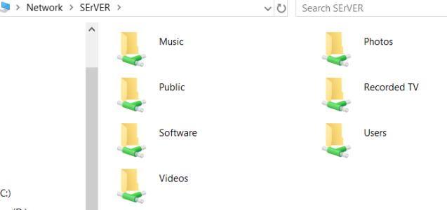

Not only that each of the machines has no trouble accessing folders of each machine. For example the CORSAIR WIN-10 system doesn't see the SERVER but has no trouble getting to the folders.

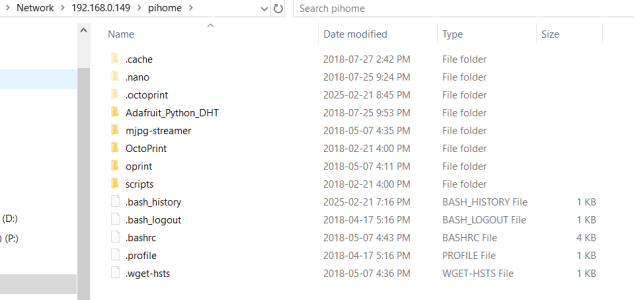

If I have the IP number I can still get at the folders as presented by SAMBA share. Here's the OctoPi Linux.

This feature was already enabled on the problem WIN-10 machine. However compared to the laptop what wasn't switched on was the telnet client. I clicked on that. The system went through a looking for files sequence. I then rebooted and now the machines are all visible.
It's possible the Telnet wasn't required but the applying changes dialog then 'fixed' something: This now matches the laptop and this web page:
