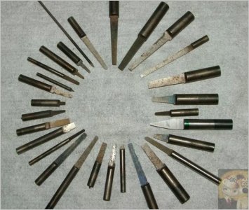

Depending on your machining skills & how hard the material is, that might be a candidate for a 'D' bit shop made reamer.

are you talking wood pellets or lead air gun type? I have made sizing dies for larger slugs from stock rod by drilling undersized, manually reaming to end size and than turning an emory cloth arbour on the mouth to give it a small taper start.

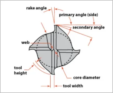

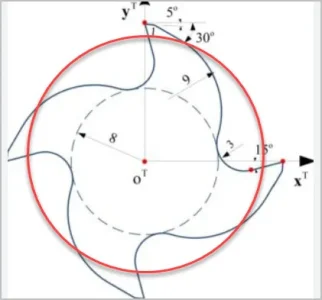

Not sure I understand. If you rotationally grind a conical taper shape from a cylindrical EM, I don't think the cutting edges exist anymore. A new edge would require new secondary relief all along its new helical path. Assuming one had a tool cutter grinder & the fixtures.
Obviously it depends on how big the taper is and how long of a cutting edge is.
If you want a custom taper generally you have enough meat on an endmill to grind it. FYI when end mill are sharpened commercially They do reduce the dia, and they do this several times to the extent they are dramatically snaller.
Yes you cut your edge and then cut your relief edge. If you start with a tapered end mill you can increase the angle even more.
And yes your flute is reduced but as long there is flute you should be good.
