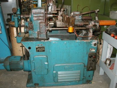

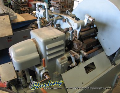

As a matter of fact, I had a swiss made cam driven lathe called a Traub model A42 (bigger version of a screw machine). That is the machine I used to make various simple parts like bushings, spacers and rollers for a trolley system by the thousands. It was a gravity feed machine and I loved operating it even though it kept me running to feed it material as it ate up bar stock at a tremendous rate.

Did you have to prep the material ie grind or turn it down to a precise diameter first? Got any pics?

It was a single spindle machine with five cam driven tool slides, including tail stock, front and back tool posts on the cross slide, a part off slide and material stop plus another cam controlling the collet chuck. For the most part, I didn't have to prep the material as the ends of the material were typically a saw cut or a rolled finish bar end and slid through the main lathe spindle on it's own when pushed with the feed bar. Only bars that were super rough on the end needed to be touched up or squared off.
I had mine set up to make 1 3/8" diameter rollers out of 6-6 nylon. The rollers had a large radius on one end to fit 3" aluminum wide flange track and a stepped hole in the other end for the trolley wheel shafts to fit. Including opening the chuck, advancing the material and performing the machining cycle, it took 5.5 seconds apiece.

This machine could tap from the tailstock with a double spindle set up. It could auto reverse. It could thread mill and/or polygon mill flats in front or behind a machined shoulder. It could be set up with a vibratory blank feeder to perform second operation machining with no operator touching the pieces. Of course, it could catch the piece and place it in a catcher basket.
