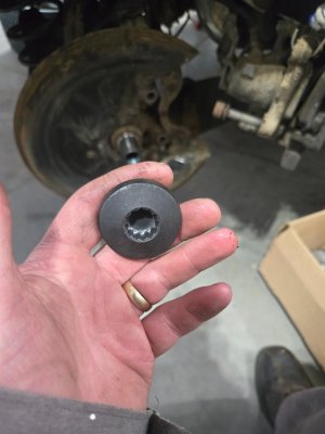

Here is the triple square socket head bolts from the rear axle on my vw.
The front has one E-star/torx on one hub and one hex head on the other! I suspect the hex head was an after market fix job.

VAG lists the part number as N-101-045-01 '12 point socket head screw' with an M7 x 18 designation (7mm thread, which in this case is a pitch of 1.00, 18mm long on the shaft). A standard 9mm 12 point socket fits it. If it is not that, then it is not the original screw OR someone messed it up somehow, or the tool you are using is messed up.

it honestly just looks like a 12pt fastener, like what ARP sells

That's the part number for the bolt for sure.
I have a 9mm 12 pt so we shall see if that works.
