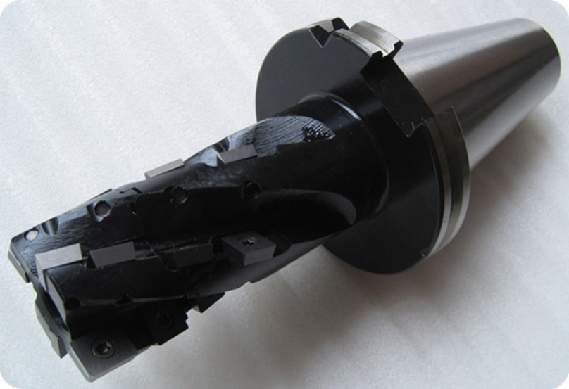

What kind of endmill is this?
justin1
Spotted this interesting designed endmill. Doesn't look friendly to sharpen and curious if there is a reason it's designed this way.
Matt-Aburg
I am pretty sure this is a variable helix endmill. I have included info form a few sources.

Interesting I imagine they sharpen it on a CNC tool grinder of sorts. Don't imagine it would not give big advantage for manual machining more for the CNC machining world.
I suspect more of a specialized router bit for a particular profile.
Variable flute endmills are different in that it flute is not stepped like that and if you look carefully the are spaced slightly different and sometimes on a different rake.
The serrations are chip breakers and generally on roughing bits but not like that, lately I'm finding the new roughing bits don't have those anymore either.
What is interesting router bits and end mills can almost be identical. The biggest difference is the router bits are ground so they have less contact surface to reduce heat absorption as wood/wood chips don't transfer heat and only the bit does.

My box says its patented "spiral-kut". From US (Cleveland, OH)
I don't see much of a difference - maybe you see it taking a bigger cut - finish is very good - same as with regular EM.

Me bad, it should be "Crest Kut"
I have same gray box, with 3/4 EM.
You can buy them new on eBay - but feel pricey - https://www.ebay.com/itm/275166261600
Well that explains a lot as I believe that these are the precursors to modern chip breaker roughers.
Roughers even now seen to have less chip breakers. In the last couple of years cutter design seems to have progressed dramatically.

OK, that explains that. What is missing on these is the wavy pattern in between the cutting edges as per the original post by @justin1 above. The wavy pattern on the cutting edges is interesting on its own, but the pattern in between cutting edges is mesmerizing! My curiosity is killing me. I'd sure like to know what that's all about.

I still feel like it's a CNC thing vs manual machining.It seems more beneficial to CNC were faster run time and less tool changing is a bonus. I feel like plastics or aluminum being most beneficial I can't see how it would perform better then carbide in steel and it's alloys
