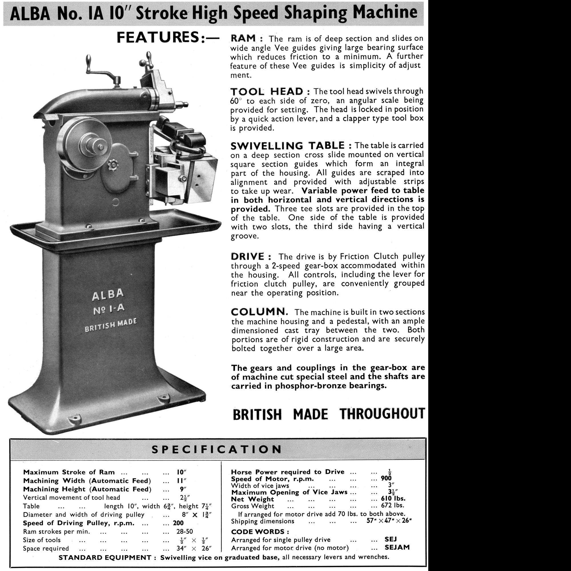

So last Friday I took a 3 hour drive to pick up an old shaper, an Alba 1A. Only 3 pictures on the website, so was a bit of a gamble. Unfortunately a nasty flu had started in our house beginning with my son a couple days previous, and I started feeling it coming on during the drive home. So, it sat tarped in the truck in the driveway till today.
IMG_20190419_145327490_HDR.jpg IMG_20190419_145105368_HDR.jpg IMG_20190419_145053545_HDR.jpg
Been sitting in a barn for quite a while, so a bit of rust color to the critical surfaces but not bad. Got lots of crusting/peeling paint of various colors and some rust in non-critical areas, and although there are a couple parts that show evidence of crash repairs it looks like it hasn't been abused.
IMG_20190425_144408214_HDR.jpg IMG_20190425_152308057.jpg IMG_20190425_152315660.jpg
Had to disassemble it to unload it and wanted to go through it anyway, noting which small pieces are missing or needing repair. So, here's my new toy that the other toys will help fix.
Been able to find a scan of the original manual, still working on the serial number trying to figure out when it was made. I did have a question for any seasoned shaper veterans, and that is what was the original Alba color? This thing has multiple layers of paint, and if there was no 'standard' color then I'm thinking of using my favorite 'candy apple gray,' like one of my viewers calls it, lol!

Under no circumstance am I a seasoned veteran. But we had an Alba in my junior high school metal shop in the 1970's. It was gray.

It was St Greg's Junior High School in SW Calgary. I could be wrong but I think Albas must have been British? because the shop teacher was British and always talked about what great machines the British made...so I think he was biased. But I may have that detail wrong.

There is some Alba info--and drool-worthy pictures--on:
http://www.lathes.co.uk/Alba/
The restored machines are either a blue-gray or sea-foam green. We won't tell if you use another colour!

I'm thinking about getting a shaper, but still on the fence. Love that the table can be rotated to an angle; I imagined the smaller shapers have fixed tables and one must incline the work in the vise, rather than rotate the table. Or... (silly question) do all the small ones do that? The only shaper I'm familiar with is the G&E on Abom79's channel.
