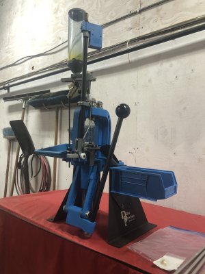

Actually , for someone that will only ever need a single stage for a few rifle rounds then ya, that is what I would recommend...but for anybody that has even the remotest need for a rotary-semi progressive or full progressive I have no qualms recommending that that is what they buy if they so choose as the progressive aspects of these presses can be disabled to a "single stage" condition to learn on and as they learn the game, their already set to speed up.
My Dillon 650 requires 2 screws to be removed to change from single to full Progressive.
