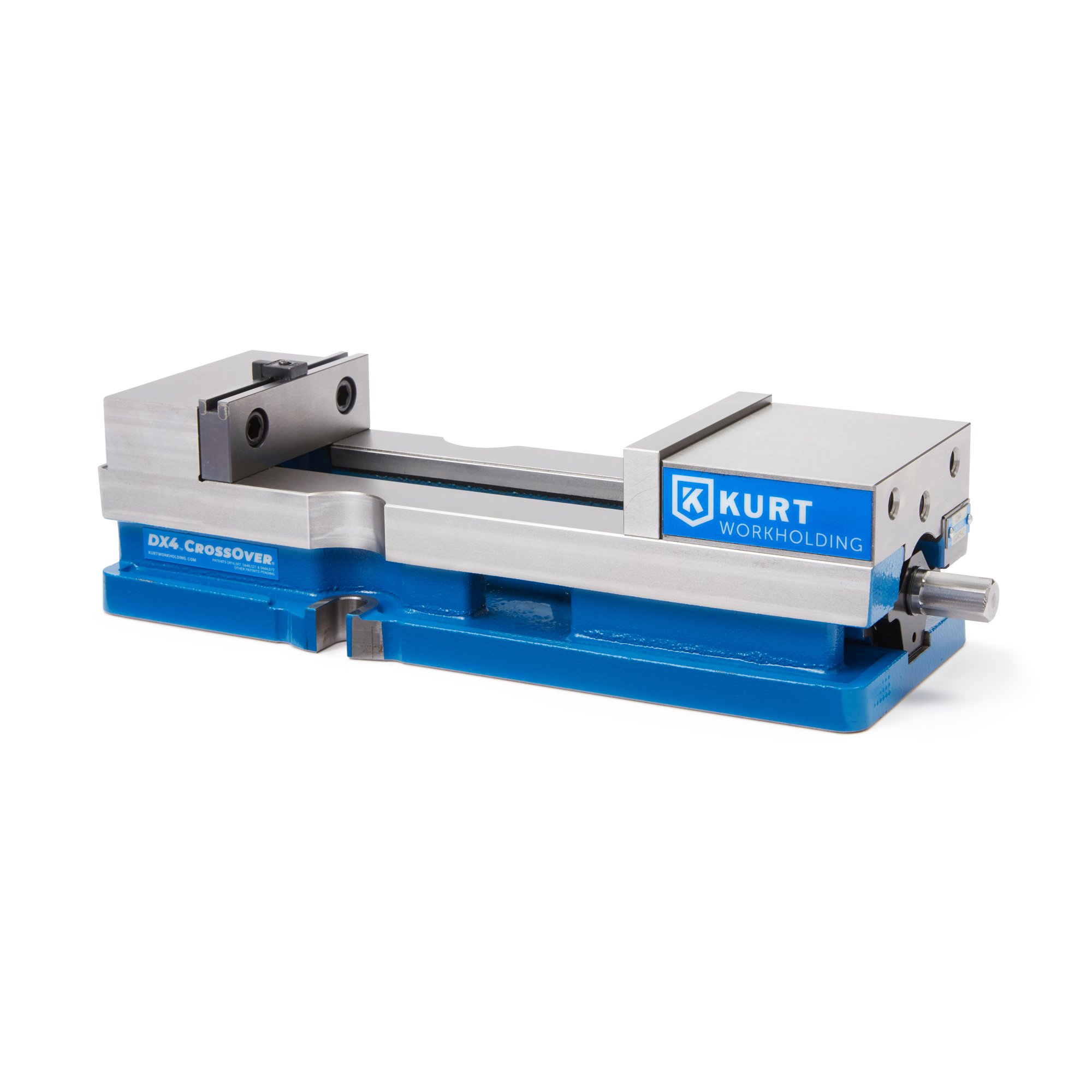

Kurt occasionally offers scratch and dent sales on their vises. I picked up a DX6 last summer from them for about $750 delivered. This is much cheaper than buying new from any of the regulat tool companies. Also most vises will require you to pay shipping since they are drop shipped from Kurt anyway. I cannot find the blemishes on my vise And am very pleased with it.
Currently the have a DX4 on sale. https://www.kurtworkholding.com/product/kurt-crossover-vise-dx4-sd/
