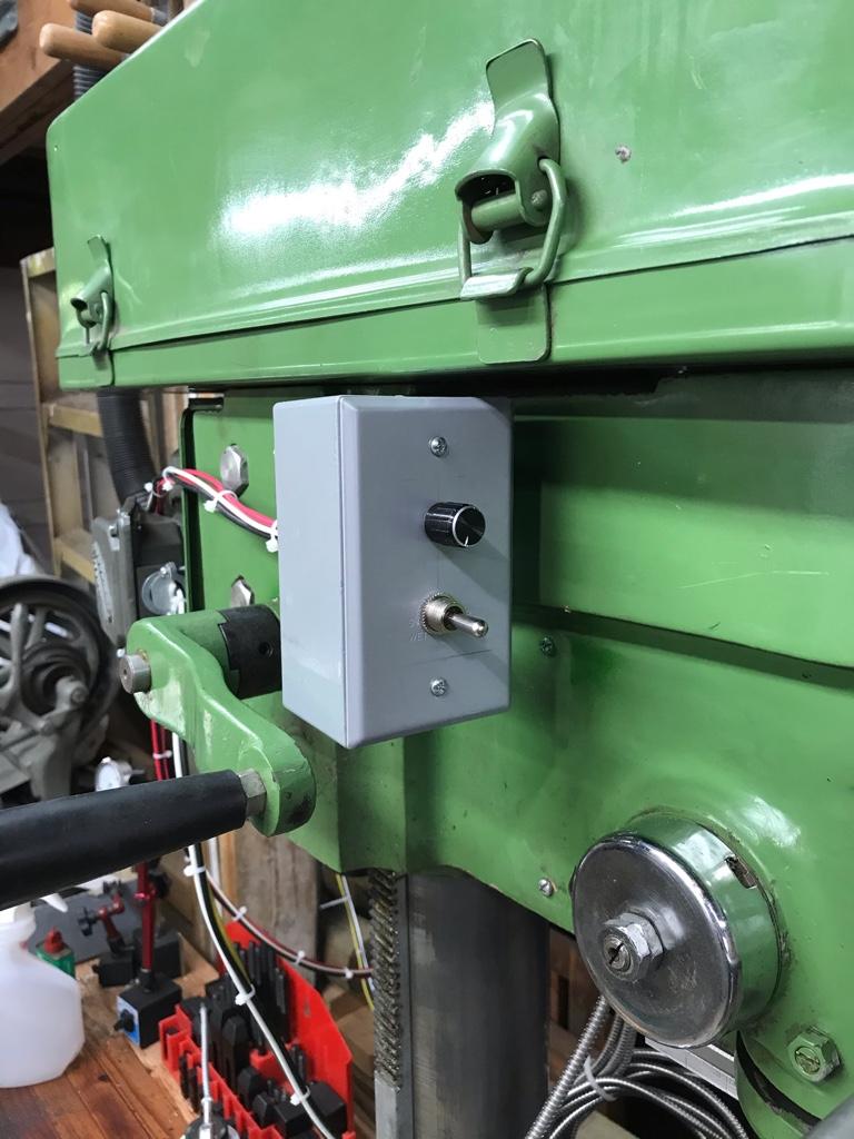

@David_R8 When you installed your VFD what did you need a POT for?
For the variable speed control.
Edit: added pic.
The knob is for changing the frequency/speed and the switch is reverse/off/forward
