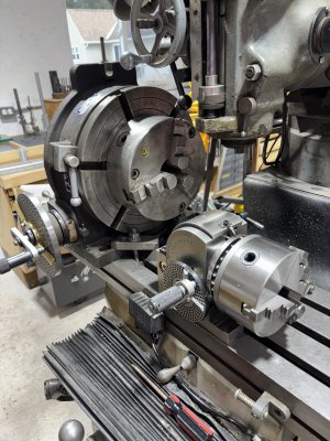

So I purchased a Vevor BS-0 or 1 to help making gears and such as my 12” dividing head is very heavy with an 8” chuck. Mailed from BC it arrived today - impressive 5 days across Canada BC to NB

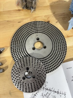

So the dividing plates were all right and range from 31 to 49 holes (have to confirm) and you get 3 with 6 lines of holes. I had to clear swarf out of 2 of them but they look fine

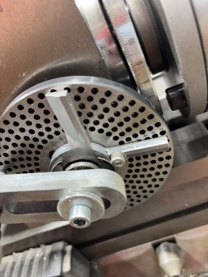

The index plunger was stiff and needed some tuning up - might need a better spring (like a bit more load pressure). The pressure clip that holds the clock arms in place was too big for the application and I had to grind off about 3/32 to 1/8 off the outer edge to get a solid fit and no interference with the clock arms. I changed out the allen screw holding the plunger with a set screw and changed the stupid Phillips head lock screw with a allen head cap screw.
Size difference is huge which will help my back as well as allow full use of the mill height.

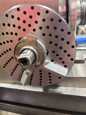

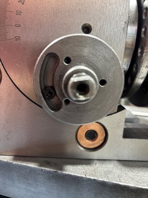

Ok, so some things got better. After removing the indexing plate there is the ability to engage or disengage the worm drive. This allows you to remove all the backlash as well as run the head with a gearing system (if you wanted).
As I mentioned earlier I ground back the edges of the clip that retains the hands.

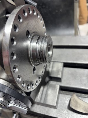

I removed the 3 jaw and the threads were quite crap at the inside edges. Just needed the paper thin material filed out.
You can see the wavy washer effect. That filed out fine and all things thread on fine. Looking forward to its next project.
