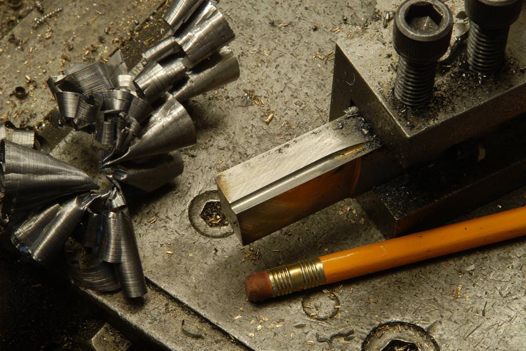

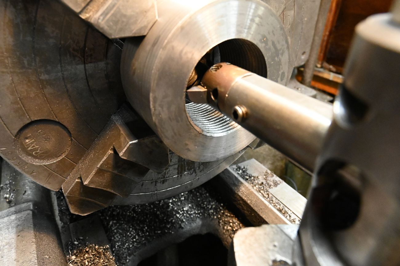

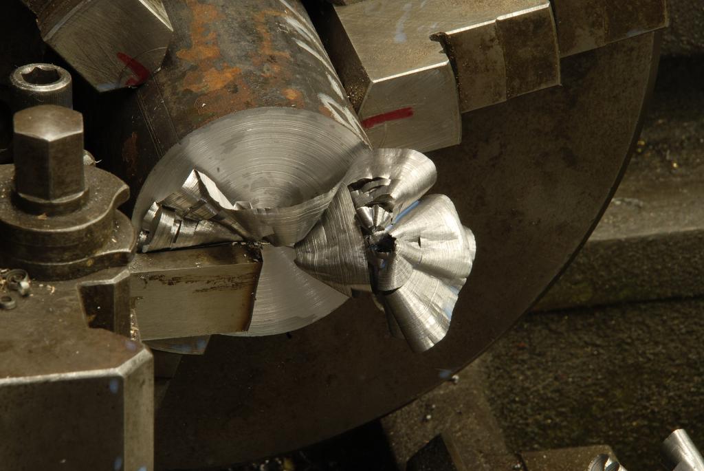

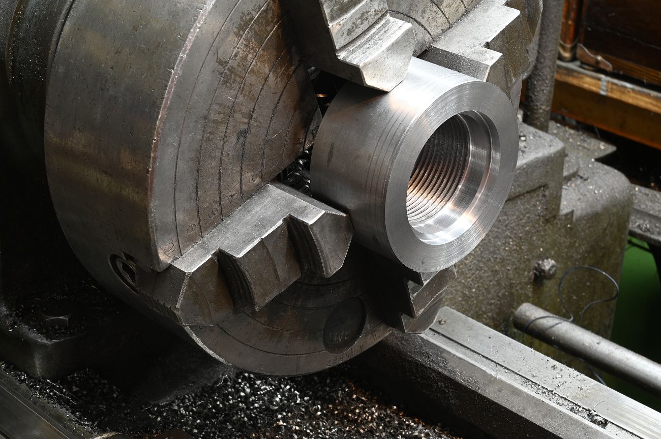

just for kicks, here's taking a 1.3125" DOC, .005 feed with a HSS bit. lots of rake via a big chip breaker. (admittedly, not a brilliant move pushing a machine to see what I can do, but the DSG didn't sound like it cared). Third pic....last weekend...cutting 57.6 x 3mm internal thread, lathe spindle back plate, which is a coarse thread by my standards. chipped two expensive crappy Criterion carbide internal thread tools before smartening up and grinding a proper hss bit.
