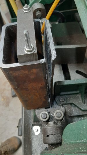

I didn't make the outboard table yet, because, I had previously made a quick and dirty solution for that.
I drilled and tap 1/4''-20 on the existing outboard section for some threaded rods and a clamp jaw to go in between. It allowed me to cut very small pieces of stock, which the original clamping vise would not hold. It can also clamp large pieces in odd ways. The last picture is a 7" tall piece of rectangular steel, I made a C channel out of it.
