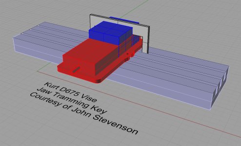

I've attached a picture called a "Jaw tramming key", seems like it would be pretty handy for rough alignment and would only need a few bumps to get it true.JawKey3D.jpg
That is a great Idea provided it lines up over a t slot so your bolts will go in , my vice came with alignment studs that bolt on the bottom but I took them off for ease of moving vice around.
I don't quite understand what you mean.. your fixed jaw should be able to line up with a slot or you wouldn't really be getting any support would you?
I have a 4 inch curt style vice and the distance from the fixed jaw and the hold down tabs on the vice base is greater then the distance between t-slots on table.

You could make the same thing with offsets for the t-slots, it would look like a channel iron profile, then just mill it flat once locked into the slots? Its not a final position, just gets you really close to alignment on the chuck..
I used to use a home made setter-upper jig, same principle of the Cad pic shown. Actually it was a long bar almost the length of the mill table figuring the would give max accuracy. The bar ends had vertical posts contacting the T slot edge. My intention was to start out with a pre-zeroed vise, adjusted the posts to make contact & the jig remains like this. Now with the vise returned to table, you clamp the jig in the exact same manner & secure the vise. It worked pretty good, but it still wasn't 100%. Always +/- 0.001" which you can improve with a DTI. The setup bar needs to be very rigid so now the length works against you vs the smaller jig shown. I think the bigger issue was that vise had side lugs, so when you tightened them down to table, it tended to shift/rotate a bit even with washers. The other style with vertical clamps in a side slot seem better IMO. (plus that vise style can also lay on its side for more utility).
