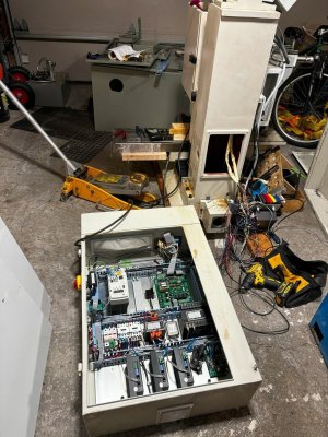

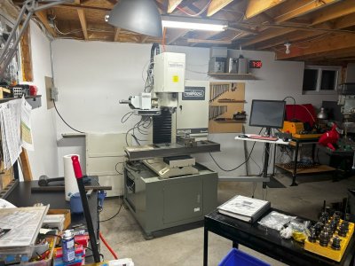

In the followed me home category. The mill somehow has managed to disassemble itself, crawl downstairs to my basement, and reassemble itself (mostly) in the corner all the while displacing the ZAY12X that was there up into the garage.
This mill has most of the bells and whistles that Tormach sold - ATC with power draw bar and full enclosure. It came with the Tormach 5" vice, coolant pump and 17 TTS tool holders, including a tension/compression tapping head.
So far I've got it back up and running and setup / realigned the tool changer.
Next I'll need to check for level and tram, hopefully its still acceptable after all the disassembly and moving.
The enclosure just isn't setup yet - its a lot easier to access things without it so it will go on a bit later I think, but playing with my vices, it looks like the 6" will be too big to use with the enclosure (or doors need to be open). Seems like Tormach optimized around the 5" vice. My cheapo 4" doesn't provide any real size benefit except for being lighter to move.

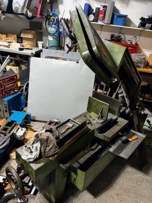

This mill was also a package deal, and I got a Kalamazoo band saw with it. Model H9AW - 9"x16" capacity. Its just a bit too much saw for me to keep it (700lbs). I'll post up more pictures of it once I finish reassembling it from my cleanup efforts, I'll be posting it up for sale.

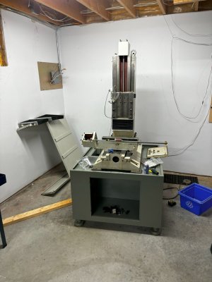

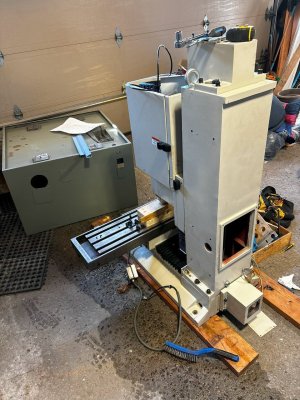

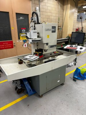

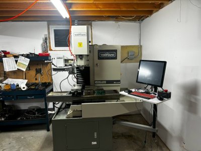

First pic is how it looked when I picked it up, next 2 are it partially disassembled in my garage, followed by a reassembly progress pic in the basement, initial placement and finally tonight's efforts of moving into what should be a final position. Lots of other stuff now needs to move (bench, drill press, Emco Compact5, wrench board, etc.).
Last pic is the Kalamazoo - its a bad shot as my garage was so full I couldn't stand properly to get it in frame!

Thanks for the advice on coolant. I dabbled with coolant on my old mill and as I didn't use it much I did end up with an aquarium bubbler. Sounds like putting it on a timer is the way to go, will help reduce the evaporation it causes.
I got the enclosure mostly setup just to see how it fits. I'll need to take it off again to seal up the joints but that will make it a 2 person job for reassembly.
It was nice to see that the enclosure actually sticks out a bit in front and spaces the door out about another 6" so I can probably use my 6" vice.
I also now need to reposition the lights in the shop. The mill has 5 lights in the cabinet so you can see in there, but now the cabinet casts shadows on other benches and tools so I need to fix that. And the last "fix" before its truly operational is to extend the E-stop and power on button, its cord is about 1 foot too short with the enclosure on...
