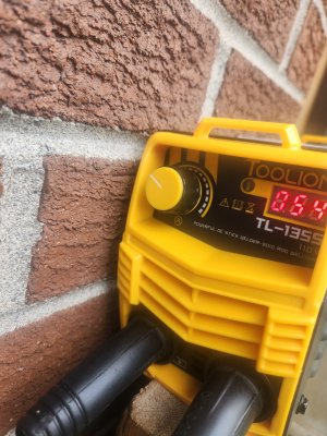

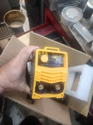

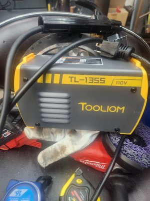

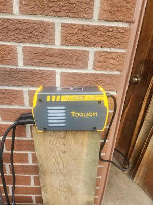

I've had this thing in my Amazon cart for months. Curious, but very skeptical about it's quality. It went on sale this week for $89 so I figured what the hell, I've blown $100 on dumber stuff before....
First impressions are that it's hilariously tiny. The stinger is decent for the price, same with the ground clamp. The high gloss on the cables made me sigh thinking they'd be that stiff plastic stuff, but they are very flexible. Same for the power cord. They've finally figured it out......

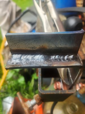

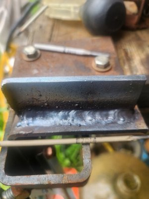

I also bought 5lbs of 3/32" in 6011, 6013, 7014, and 7018. Just playing around with stuff so far, but it's ran every rod just fine. Below are my attempts of a 7018 multipass tee, and a 7014 on the other side. My first time running 7014. Nice rod, I like it, but I need to play around with it more.....

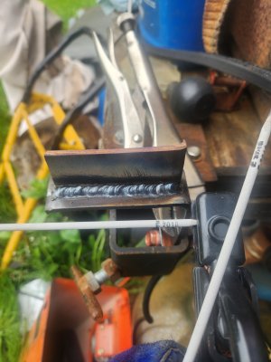

And a crappy 7018 vertical run on top of the other weld...
For under $100 this little thing is awesome. I want to see how it welds off a generator next, but even for mobile site work this is going to be great. Will be very handy out in the blacksmith shed too. I made those full pass welds, ~3" long and never tripped a 15amp breaker. You can get these in dual voltage, but I didn't see the point. I have my big 240v welder for that, and lots of cable. This fills a different need, and as long as I could burn 3/32 rod with it I'd be happy. And I am. Very :D.
It's smaller than a battery grinder....
Ok I thought this was a joke at first. It's comically small!

That's even got a 60% (advertised) duty cycle. I would've expected closer to 20% or 30% for a machine that physical size.

Ya, I thought it was too good to be true too. I have some projects to do in the blacksmith shop, so I'll be using it in there a bit. When I'll get to that I don't know, but hopefully soon. I'd really like to burn a lot more rod with it, as it honestly welds really nice. I dare say MUCH better than the Miller suitcase we have at work. This lights up a 3/32 7018 with zero trouble, and the Miller sticks rods like crazy..... It's less than half the size too....
