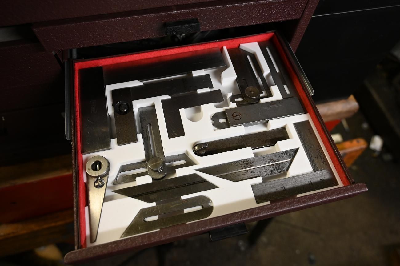

I'm going to have to come over for another shop tour to see all those drawers under the lathe filled with specialty cases
I didn't know about this gridfinity, interesting. I just did a drawer of almost all boxes, stuff like exacto knives, rules, pin vises. imo it creates space because these sorts of items can be piled up and the box keeps things together. Gridfinity may been useful there, but for machinist tools, I think you get real space saving by nesting stuff.
Those look great! But I don't quite get why you left the adjuster ends & wrench extending external like that (as opposed to encompassing them like a regular box). Is it a camera angle thing or maybe I'm misunderstanding the pic. Another nice touch on some cases is the finger indentation to grab the instrument in preferential spots. Slots for related accessories or calibration standards. Or a relief on back side for instructions...

Hey Peter, the indicator holders are taller than the DTI holder so my intent (and we'll see if it works) if for the indicator holders to overhang something lower. Since the Gridfinity systems works on a set grid I I was trying to keep them inside a few grid spaces as possible. If I made the box 1 x 4 to accommodate the end of the barrel there would have been wasted space.
A side view is likely helpful.
The wrench placement was a design mistake :rolleyes: I should have shifted it further along the length of the box.
Here are some of the printed holders I've done. More are done now, its the sort of thing where the mood hits or it doesn't
Those look awesome. I presume you're keeping the boxes? I like the Mic storage drawer.
