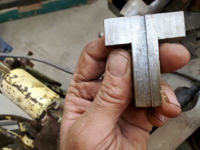

Mine is set up for 1/2" hss, but, it's a little bit bigger.....
What am I looking at in that last photo Don? There seems to be a lot more there than a piece of hss in the lantern tool post.

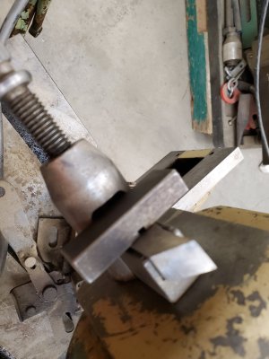

Maybe you can see what is going on better with this picture. The hss is out of what I call the "sled". The sled is just an adapter to fill the space between the hss and the tool post and the tee is just a packing to take up space, the "T" portion just frees up a couple of fingers while setting up the cutter. The shallow groove running down the inside of the tee allows me to dribble cutting oil down the front of the tool and it kinda acts like a mini reservoir.
No wonder it didn't make sense. There REALLY IS a lot going on there! I especially love the oil groove!
So ultimately, the idea is to stick a piece of HSS into the sled thingy to totally replace the tool holder and the tiny piece of HSS that the tool holder holds with just one bigger stronger piece of HSS? No?
If so, it's EXCELLENT!
As long as it doesn't drive too much stick out, it should be superior. Thinking that the concept also makes for a much easier simpler grind too.

Yes sir, I think you have the jest of it.... It's not the perfect tool for every occasion, but it is my go to set up for most operations. I wish I could remember who's YouTube channel I stole the idea from so I could give credit where it's due..... Shaper Andi used to have some pretty cool videos, but they seem to have been taken down for some reason. His tee slot cutting setup was pretty cool.....
