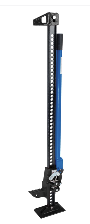

I see the vevor 2.5 ton hydraulic toe/machine jack is about $75. That seems pretty reasonable. Would a farm jack work or is the minimum height too high to slip under machines? PA has this for $99. Similar farm jack models at vevor too. Checking the specs it seems farm jacks have a pretty high minimum height 100mm or so - probably too high and won't work.
I've used these before, don't. They love to slip, make the machine top heavy, I speak from experience I had a hydraulic jack so cost of some scraps or as my quilting wife says even the smallest scap still cost you the same. On the other hand if the vevor comes with the jack and you can wait, buy it.

Good to hear your first hand experience here Randy that a farm jack is a bad idea.

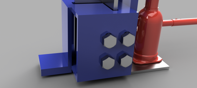

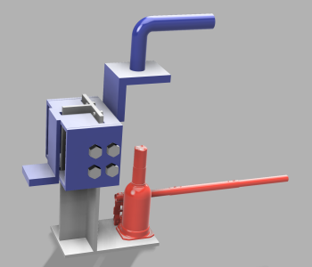

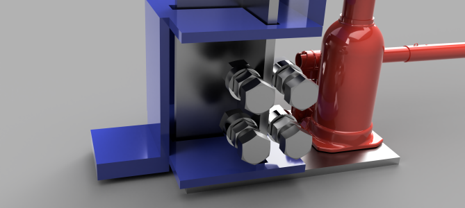

I had some time to work on a Fusion design, just for my amusement. It is over built & over designed. CAD says it weighs 10kg. A few screenshots. It does make we want a CNC laser or plasma cutter that can handle 1/4". A bottle jack model downloaded & scaled from mcmaster rounds it out.
View with side panel removed. Four bearings roll against the "I" beam. 1/2" bolts holding a 22mm OD bearing. Same on the other side. I think you could get by with only 2 bearings on each side - the top right and bottom left ones. The "I" beam & base is just some 1/4" plate welded together
