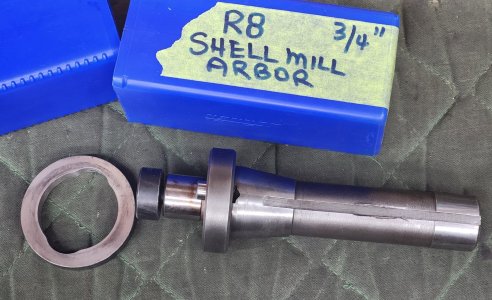

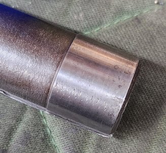

I also picked up a right angle head for my Excello. Saw it advertised last week for $225, and drove up to get it. The guy had bought it for his taiwan b-port clone, and it didn't fit (Excello's have bigger diam quills). Owner before him had turned the r8 adapter down to a straight shank for some reason (and was just using the drawbar thread to drive it apparently....), and it also felt really tight, so I offered $100 with these issues in mind but he didn't take it. We chatted for a while about machining, jobs etc, and he mentioned he needed some cad work done so I offered to do the modeling in exchange for the head for $100. He said he'd think about it, then contacted me this week and said sure, so I whipped up the parts he wanted modeled, and drove up after work to pick it up. I'll know more when I get inside of it, but I'm not the first one inside of it obviously.... It's very tight spinning, but I'm hoping it's just a preload problem, and that nothing is damaged inside. I'll also have to make an r8 shank for it, but that shouldn't be a problem. For $100, I'll take the issues in stride.

Thanks. I remember reading your thread when you posted it. Just going over it again now, and your head is different than mine. Do you still have the r8 arbor you swapped out? Wonder if it would fit mine, even though they are different.

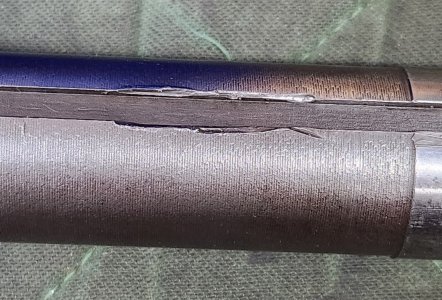

Aside from being absolutely PACKED full of grease (I'd already knocked a bunch off before the pic), the gears looked in great shape. Bearings felt great as well, and the seals looked in decent shape too. Cleaned of a pile off grease to have a better look, and everything seems fine inside. Reassembled it clean to give it another check and it's MUCH easier spinning now.....Stuck it on the mill, and gave it a quick whirl. Only ran it up to 500rpm because it's just the drawbar thread doing the driving, but it's fine. A bit noisy, but nothing too concerning. I'll give it a proper cleaning and relube once I get the proper r8 arbor.
I think I did alright on this one. It being really tight and coggy had me worried, and I still don't know why it was. Assembled wrong when I got it maybe? In my scouring of the internet this morning I have not come across another excello head that looks like this with the 2 piece body. All the other ones I've seen are like Stelster's. That style looks a bit heavier duty so I wonder if it was a later style and they beefed up the design from the ones like mine? If I'm reading the serial # right this is the 574th head they made. The 2 piece body might come in handy for me, as I might see what it would take to make another clamp to fit the spindle nose of the Tormach. I just thought about that while typing this out, might be handy someday.

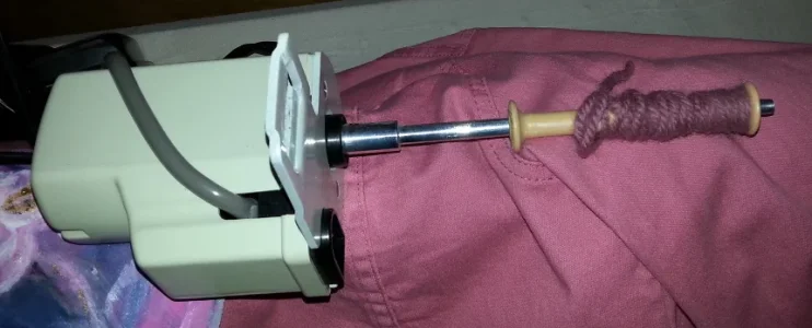

Not perhaps a weaver? Many decades ago I was my wife's partner making handwoven clothing and doing the craft fair circuit. Made a bunch of bobbin winders (machined tapered spindles) powered by recycled sewing machine motors for other weavers. Actually left my job at the machine shop to be able to do that (the weaving, not the winder making!) and work at home while the kids were little.

I like the bobbin winder, I can see that being very handy for weaving and loading shuttles. I initially used a sewing machine motor for this winder, but it didn't have enough power to swing both arms winding 6 skeins from cones (only one arm on right now). Ended up using a 12v wiper motor I pulled from my old G6 before scrapping it. It's about 4-5 years old now and still going strong, and it's wound a lot of yarn. Blown a couple PWM control boards, but they're cheap. The aluminum fingers are new, as the old 3d printed ones finally broke after a couple years use. I have a couple more upgrades planned for it If I ever get around to them......
