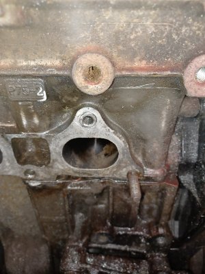

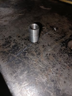

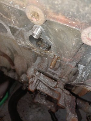

Homemade "helicoil" to repair a blind hole that had a broken bolt and then an extractor broken off inside of it. This is a friend's ice racing car (like $500 junker) - he can only work on it at my place on the weekends and he needs to have it up in Minden next weekend.
Good enough for the girls I date... sometimes you can't be perfect.
Wow! I'm impressed! Not sure I would have tackled that one!
For bolts and extractors that get broken off in a blind hole, nothing beats edm. But that's not always an available choice.

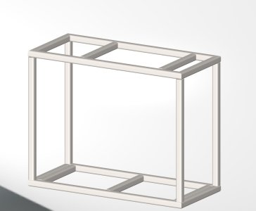

Also designed a rough version of a "stand" or base for the lathe last night w/ room to install an older Gray tool box (similar to the Craftsman in the pic) that I have kicking around. I didn't set my tool boxes up for all of the machining tools that have started flowing into the shop.
And then, I measured where the lathe center height would be... there's not enough room for that tool box under the lathe... :( I saw others use the intermediate/middle boxes and I think I will likely need to follow suit.

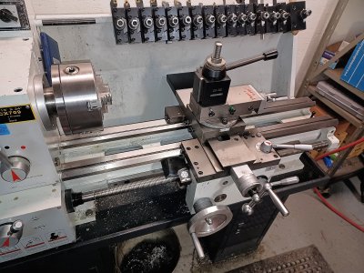

CX709"x" progress - performed the oil change using Universal Tractor Fluid which definitely is thinner than what was in the machine. It took me a bit to figure out where the drain plug was and I'm wishing I had some sort of spout to help get the oil from the drain plug outside of the end cover and into a drain pain. Taking into consideration someone else's comment on their oil sight needing some improvement, cleaned it up and removed a little plastic divider thing that was inside of it.
Without the 3-jaw chuck installed, the motor could turn the spindle at 1650 rpm but it took a little effort to get going - fluid being warmed up also helped a touch. When I installed the 3-jaw the motor stumbled and did it's bucking thing until the breaker tripped. I reran it in a lower speed for a couple of minutes and re-attempted to run it at 1650 rpm... it ran... it took a noticeable amount of effort to spin up the spindle to speed. I'll continue to work around it but can see potential issues if I need to turn more than 850 rpm/there's load from the tool/work.
The motor is lacking power/torque.

QCTP is installed although there will be some modifications and improvements made in the near future - thanks for the help.
Way oil on the ways instead of 75w90 works WAY MUCH BETTERER! *grammar mistakes are on purpose, that's how much of an improvement it is*
This is a big disappointment. I had high hopes for the lighter oil.
It might be worth letting it run a while to give the lighter oil a chance to find its way into all the bearings and sleeves.
