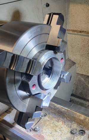

Just last night I was machining an adapter for an tractor engine starter for a neighbour. It's made of 1" plate. It needed to bored out to fit the new generation of starters which are 60 thou larger in diameter.
He didn't think the Jaws were tight enough cuz I didn't gronk on them. After a quick, "Who is doing this - me or you?" I showed him how much it would deform if I did. He was blown away. After that he just asked why - not you should. Ya, even 1" plate bends quite noticeably.

Using a flower tray with a T-slot can be a good tool to reduce deformation because the workpiece has two holes that can be used to screw into the flower tray
