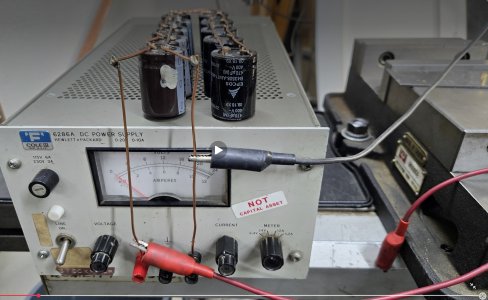

Here is his power supply setup. Someone please help me (us?) understand how this works and correct my errors? He has ten 470uF capacitors in a bank wired in parallel to the power supply which charges the capacitors. Then two wires go to the EDM setup from the capacitor bank. I think then the capacitors discharge through the pencil lead and the broken tap when the circuit is completed at the work. Why does this not short out the power supply and blow the power supply fuse? Why are the capacitors even needed?
Typically power supplies like this will have both a voltage and current limit on the output. If it's a dead short, it'll just output at that specified current limit with close to 0 volts. They can also do things like charge batteries up to the voltage limit at the current limit.
The capacitors in this case are effectively just very low capacity, very high current output batteries and allow the high current sparking. Between sparks, the capacitors can be charged back up by the power supply.
Yeah, I really liked this video/technique too, and thought that just stacking up those capacitors was clever as all hell to deliver short bursts of high current to the workpiece, then let the current-limited power supply charge them back up.
Some TIG (or MIG) welders have a pulse on/off feature - if connected up to a similar EDM setup could the welder act as the power supply?
The caps are supplying a very large amount of current in a very short amount of time. Think 12 buckets of water dumped at once vs's the house tap slowly filling them. As Sqought said the power supply likely has a protection circuit in it. Or they simply charge the caps and shut off the power supply, this would depend on how the power supply is made. Many of the designs on line have cut off circuits. Using the graphite which is conductive but will not weld to the metal being melted. The graphite has a very high melting point so the broken tap will likely go long before the graphite. Like a gouger rod but with out the air. Also the graphite will vaporize if I have that right it will not weld to the metal.
It's not really "protection" as such, but an adjustable current limiter. That's an HP 6286A, which is variable 0-20V/0-10A - an older version of my bench supply (6024A, 0-60V/0-10A, dual meters). So you set the current limit - which in this case really only affects how fast the caps recharge after a burn cycle - and let 'er rip.
