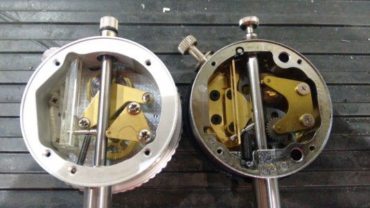

Yeah this is a great article. I'll throw in my experience with dial indicators. About 9 years ago I bought a cheap STM dial indicator when I was a first year apprentice. I still use that one at home and it's brilliant. I bought a mitutoyo dial indicator for work because I wanted the best, but it is so dam delicate it is already trash two years later. They put a pathetic plastic bezel around the dial and once that is broken the whole unit really starts falling apart. The mitutoyo is not well designed at all. I have in the past dialled in 3200lb piece of tool steel with a cheap dial indicator from China. Because it is a comparative measuring tool if you use comon sense and check it using the machine movements from time to time it will work fine. My friends that machine for Halliburton oil company even swear by their Power Fist dial indicators. Admittedly every tool I own for work is Mitutoyo but It doesn't need to be. Because we are all hobby machinists machining from home is rewarding even with basic second hand meashuring tools.

I took a picture of 2 dials to illustrate the deference between Japan and China. On the right is a relativley expensive mitutoyo on the left $20 STM el cheap O. Notice how wimpy the STM parts are compared to the Japanese dial.IMG_20150805_225912780.jpg
