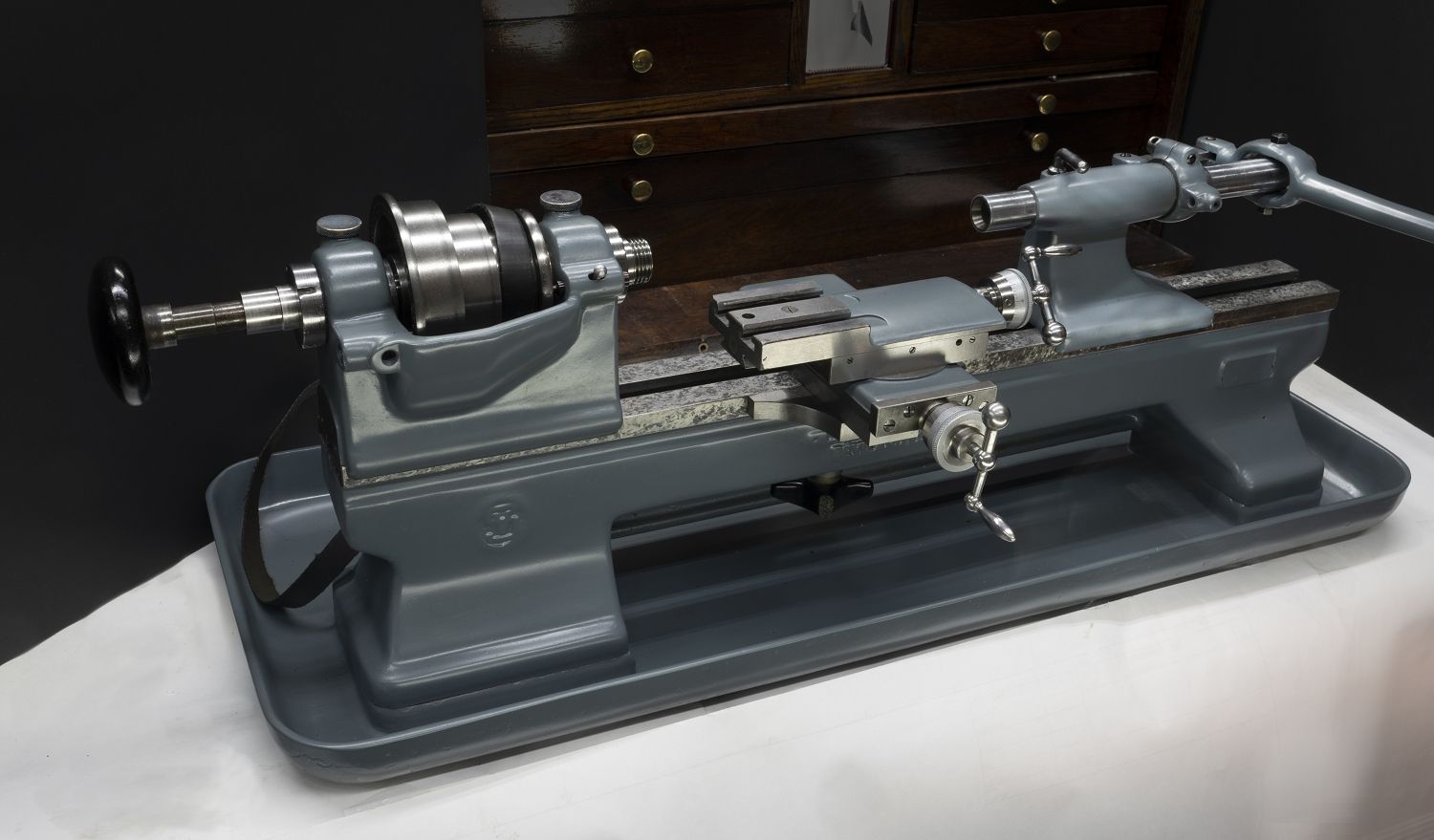

As evidence, here's an example I did in the home shop on the little schaublin. I ground the spindle (double taper) and then scraped the bronze bearing, and finally removed the miscropic burrs with a very small amount garnet fine abrasive (the stuff that breaks down). Run out is a small fraction of a tenth. No doubt Spar or Habegger or Schaublin could have done that or better.
So....armed with such a comparator, if you were suitably motivated to make the machines and spindles to do the boring and grinding (i'm certainly not, this is just chewing the fat), it would seem doable to make bearings better than P4 or P2.
Another example is Lodge & Shipley, arguably the top of the line cylindrical grinder. I've got the baby one and its all plane bearings, done that way to achieve the highest accuracy so the story goes.
See at about 16:10 here, spindle grind and bearing by yours truly. Barely any needle movement, home shop made spindle.
A long account of the headstock reconditioning
The finished lathe
Fascinating!
