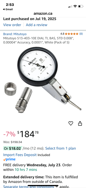

This morning I was looking at a 0.0001 Mitutoyo selling at $204 on Amazon and thinking that was maybe a better deal for than the used $120 kijiji Tesatast. Then Amazon bumped up the price to $240. From a different seller, Amazon also had a Mitutoyo 0.0001 DTI for $185 +tax (see pic below). I ordered it before they bumped up the price on me. It arrives Wednesday. 😎
