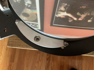

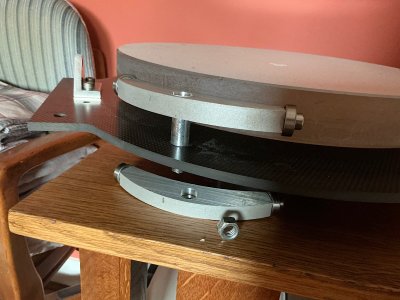

Made a couple whiffletrees for the support of the 13.1” telescope mirror. Wire EDM cut the crescents and popped a hole for the pivot bearing on my lathe. Next drilled the ends for 5mm threaded shoulder bolts to hold the support bearings. Today I cut the post that the whiffletrees sits on. They still need to be drilled and tapped for the pivot bolt.

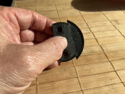

All it really shows is how the PLA support breaks away from the PETG part so cleanly.

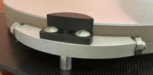

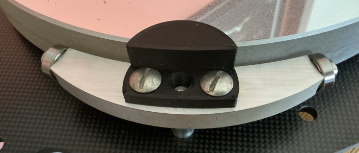

Today’s job is printing and adding the mirror clips to the whiffletrees. These and one more at the opposite side of the mirror will stop it from flopping out when looking at the horizon, as mentioned before.

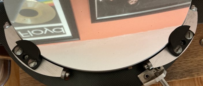

Test assembly of the support system. You can see the three mirror clips now. Need a few adjustments to the lengths of the whiffletrees posts and a few little clearance issues that some file work will fix up. Good day so far!
