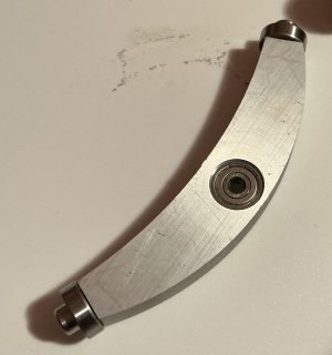

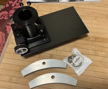

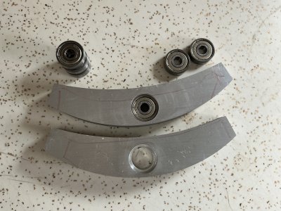

Since the sky is smoked filled, I continue to work on my telescope build.
Made a couple whiffletrees for the support of the 13.1” telescope mirror. Wire EDM cut the crescents and popped a hole for the pivot bearing on my lathe. Next drilled the ends for 5mm threaded shoulder bolts to hold the support bearings. Today I cut the post that the whiffletrees sits on. They still need to be drilled and tapped for the pivot bolt.

Whippletree or whiffletree are used in agriculture and also lifting loads.
Ahhhh! I see! Now I have the big picture! Thank you very much. Guess I have used them as a balancer on my engine hoist but didn't know the proper English name for them.
We had draft horses on my home farm in Saskatchewan when I was a boy. We called those things an "Ortscheit" - pronounced "ort-shite".
We also used them on wagons and sleds and called them a swing bar or a
"Wagenschwengel" - we pronounced that "vah-gen-shveng-gel".
Thanks for the memories!

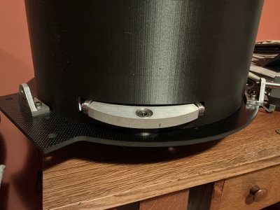

Today’s job is printing and adding the mirror clips to the whiffletrees. These and one more at the opposite side of the mirror will stop it from flopping out when looking at the horizon, as mentioned before.

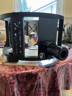

Test assembly of the support system. You can see the three mirror clips now. Need a few adjustments to the lengths of the whiffletrees posts and a few little clearance issues that some file work will fix up. Good day so far!

It is part of the collimation system. It is a target applied to the center of the mirror. It has no effect on the usage of the scope as it is in the shade of the secondary mirror. The inventor passed away a few years ago, fortunately it has been picked up by other as it is a very good system.
