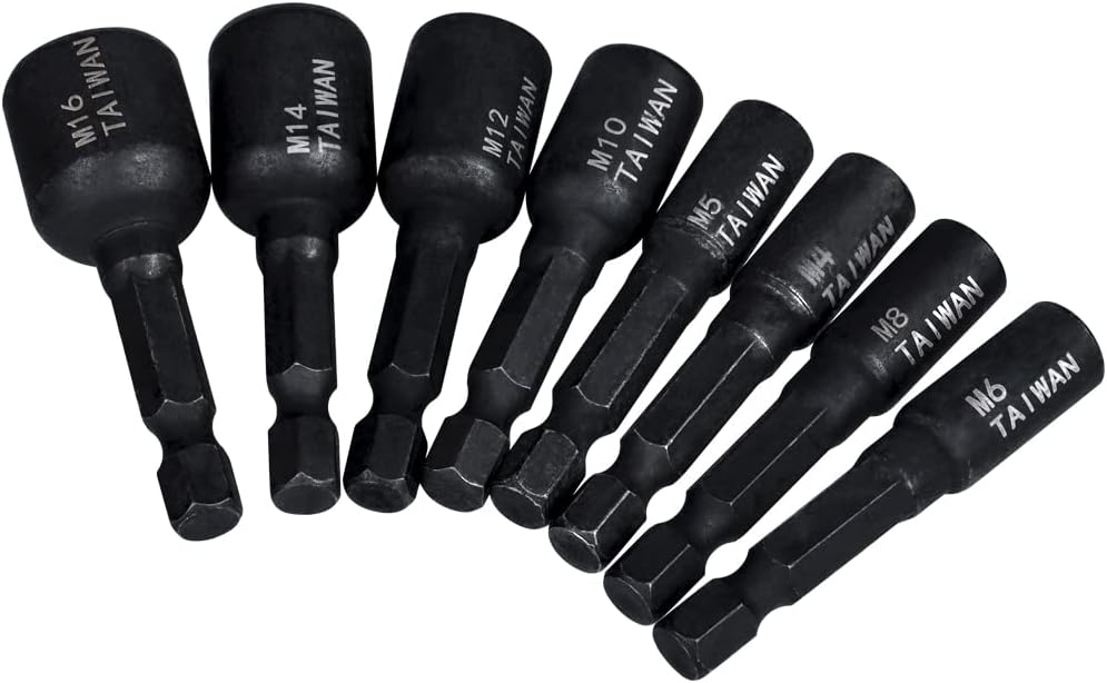

Tired of trying to get a chuck to hold a tap and cranking the knee up and down for a spindle tapper.
Looking for these in inch/imperial/SAE/U.S. Customary. I know of the alternatives, I want THESE.

Maybe this? Add a hex to square drive adapter and go?

Not really sure I know what you want. I have an imperial set of the ones @DavidR8 mentioned above. They are sockets that grip the tap and they are sized to fit all the standard tap drives. You can use them with 1/4 or 3/8 square drives depending on the size of the tap head. I love mine and usually use them. I just got mine about 5 years ago and don't know how I managed to live without them before that.

My employer has a set of Snap-On tap sockets. The smaller ones are 1/4" drive and the larger are 3/8" drive. I have used them a lot on both metric and imperial taps and they work great for both.

The particular size I've needed most lately is 10-32. On a hunch, I went out to the shop and checked some tap shanks. It turns out, that much like the thread, a 10-32 is nearly identical to an M5. Ordered the metric set. Will probably order a set of the LIsle sockets too. You can never have too many tools. Thanks to all who played.
