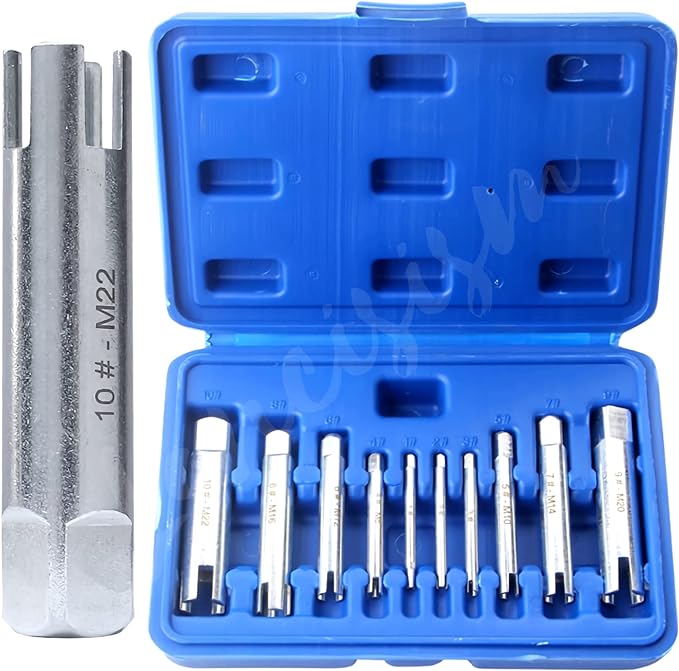

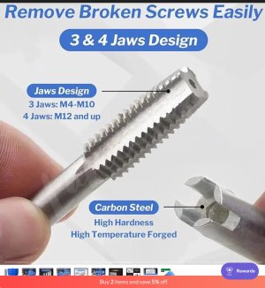

Saw this today, these would be pretty easy to make.

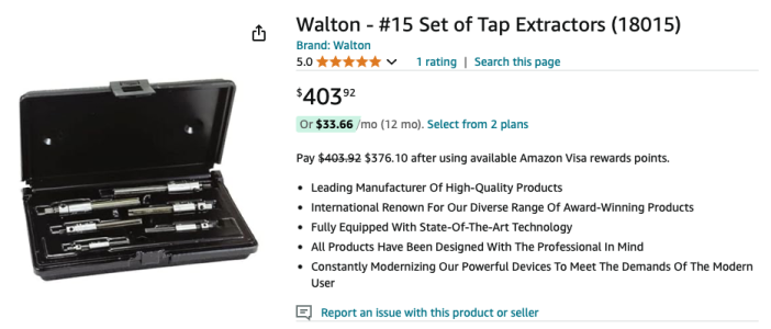

I found this on Amazon, burst out laughing, and just had to share.......
Obviously, they are usually a lot less. I like them because the pins are easy to get into the tap grooves and the sliding sleeve holds them in place.

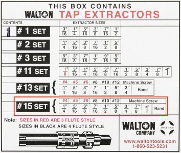

From Travers Tool in the U.S., and Great Lakes Carbide in Canada. I'll add them to my Wish list, but will reach out to Travers before buying to confirm it's really a #15 set:

MUCH cheaper elsewhere!
