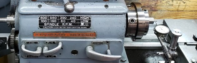

Ok guys. I feel like I’ve come to a crossroads in my machining journey.
I’ve had some good conversations with some machinist friends, and started down the firestick smithing rabbit hole.
I’m looking on my project horizon, and at this point, the projects that I feel like I need to do, and the projects I want to do are different.
Most of the projects I have to do are to do with my lathe…. I want to make a spider for the through end, and a follow rest…. And a taper attachment…. And metric change gears. A dro would also be nice.
The projects I want to do are re-barreling some boom sticks I have, making some metric adaptors (large) for some electrical fittings, and making some cable adaptors for a Buddie to sell.
I’m feeling like I might be getting a little sunk cost fallacy with my lathe, as I looked again at the modern 1440 package which has EVERYTHiNG I want, and is about 10 ish grande.
I’m catching myself now thinking hey, what if I sold my utilathe, and got the modern package, then I can immediately stop working on my lathe, and tackle the projects I want to take on……
I also realized that my through hole in my SM is not big enough to accommodate 1.2” barrel blanks, which was an absolute nut punch.
My machinist friend said to look at the cost of all the upgrades/mods and factor in the time somewhat and see if it’s worth it to keep and tinker or just buy the one with everything.
The other thing is the through bore, which I will never be able to change.
Maybe time to pass the Utilathe off to another forum member?
I don’t know. I’m ranting.

I have rarely ever had to put a 1.25" barrel through the spindle. I always buy my barrels pre-turned to a desired contour. Thinking to save a couple bucks by buying a full blank is not cost-effective. The 1.250" breach end of the barrel easily fits into the hole of a 4 jaw.
My lathe has a 1.6" spindle bore, but I have turned 2" diam. bbls. Between centers, or chucked and steady rest. Chamber, threads, muzzle, crown and all.

I always do a spider set up. There's two ways to do that.
1. 4-jaw chuck and 4-screw spider out-board
2. 8-screw spider held in a chuck
The steady was only used because I was working with 2" diameter bbls.

You have the SM1230. Spindle bore is 1 1/16". That shouldn't stop you from doing 99.9% of all gunsmithing jobs.
Metric gears: very few action use metric threads. (I made mine.)
Taper turning..meh. I made one after 37 years of gunsmithing.
Follow-rest...can come in handy, but not for the majority of gunsmithing. (I made this too.)

I prefer to chamber through the headstock too. But most barrels taper down pretty fast. Very few need the big bore spindle. Plus you can always use an 8 or 12 bolt catseye to move it out as much as needed.
Are you really gunna be chucking a straight barrel? I NEVER buy straight barrels. NEVER. I have adjusted profiles but I hate doing it. It's CHEAP to get a barrel maker to grind you the exact profile you want.
Also, there are lots of guys who have done great work with a steady rest. It can be done to precision levels but isn't as easy.

@BaitMaster - if @thestelster is right about your spindle bore, this debate is over. Go measure the heaviest barrel you could ever imagine shooting (or carry) and find out where that 1-1/16 point is. Most likely it will be around 2 or 3" from the receiver shoulder. That's hoe much won't go into your spindle. By the time you add a spider, you are about perfect for working on it. Crowning will be the reverse with that much sticking out the backside.
