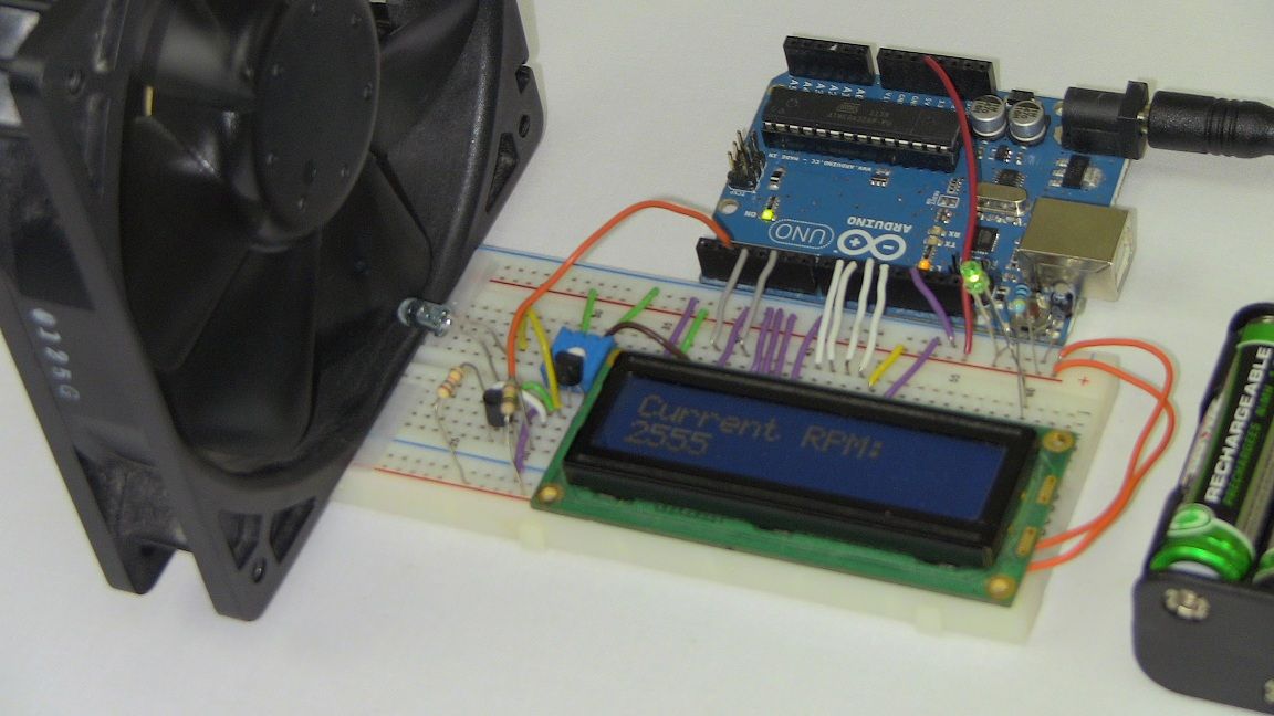

Mine uses an IR optical sensor counting holes in a punched disc attached to the quill. The Arduino code measures time between successive pulses, averages out the value after seven pulses, and displays the results. Two dials set cutter diameter and material. This is used to calculate recommended RPM and SFM. The tachometer calculates actual running SFM from RPM and cutter diameter.
Top two lines are current, bottom two lines are reference book values.

Cobbled together from this. My programming skills are best described as brute force with zero elegance.
I added code to read two pots and select material and sfm values from a simple lookup table, then use these values and a bit of math to calculate the display text.
A real programmer could probably write it better, but my hack works so it’s Good Enough.
