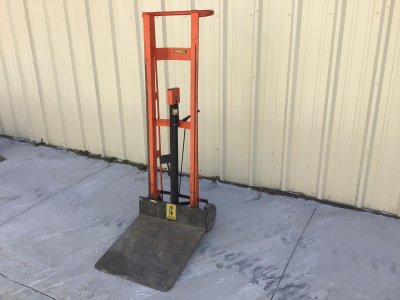

After quite a few reasonable warnings I gave it a second thought and decided NOT to mount it on the mill table. I would rather do a wooden cart-pedestal with front legs extending forward to ensure balance - similar to engine hoist. Bottom surface can be used as a storage for vise, dividing head, rotary table and it will add stability to the cart.
Something like that -
Crane itself will not be swivelling. The cons of this solution is yet another structure taking place in the shop.
Nah, I call it reconfigurable, moveable storage.
I keep my 10" rotary table and 160lb optical indexer on the top of a tall rolling tool cabinet. I pull the cabinet over to my mill, lower the table slightly below the cabinet, and slide the heavy stuff over onto the mill. When it's time to put them back, I raise the mill table slightly above the cabinet and slide them off. It's very easy to do, but I am a big guy.
I can easily move my 60 pound universal dividing head, but I might put it on the tool cabinet too. The rolling cabinet is designed to take a 600 pound top cabinet so I'm not worried about overloading it.
