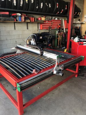

Table Build.. Finally Done

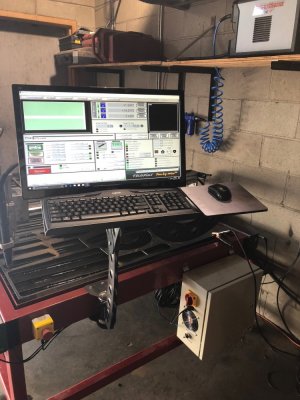

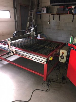

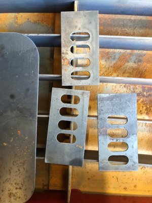

Very impressive. If you get a chance to do a more detailed write up I think people would be interested. Also some pics of the test cuts when you do them.

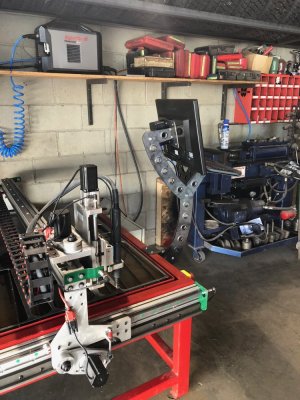

Got the table Dialed In Today.. THC is working perfect , little cable management and it is ready for some water.

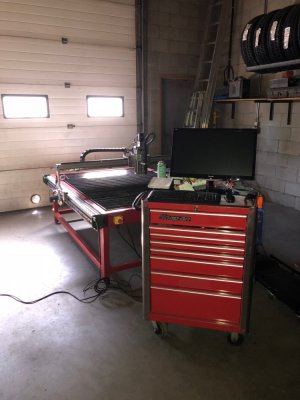

Water is pretty much a must have.. I only ran mine a handful of times on smaller (not 2 hr) cuts and the smoke that comes off is horrible for you and your stuff. If you haven't got water in yet it's amazing both how much dust it traps and how cool the part stays when the water kicks back up onto the part.

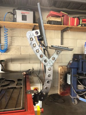

Really nice build. Really, really, nice. Good job. You might want to put a Scotchbrite pad over your PC fan intake, especially as it sits below table height.

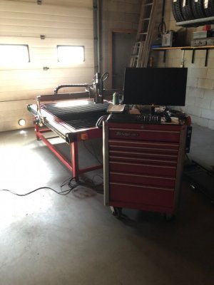

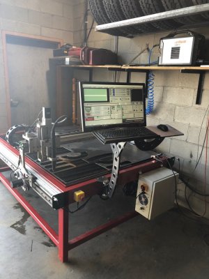

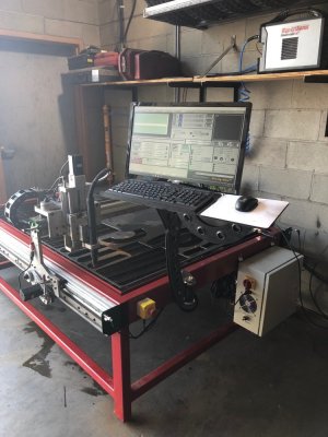

Controller is in the tan box and is filtered. if you look in the third pic you will see the PC it is a Mini Acepc AK1 with a 1 TB hard drive installed.

This will be Table # 3 for me. First one was purchased from a company in Calgary.. Was a piece of crap truth be told. Guess that is why they are out of business:) Table #2 came from Fastcut Cnc out of Kamloops .. Much better table... But # 3 is the best ... I may be bias :)
