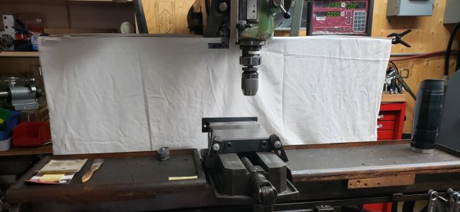

I got tired of picking up/vacuuming bits of swarf that get thrown onto all the surrounding tools.
I decided to put up a curtain. Its a prototype, using an old bed sheet. I'll probably move to something more durable like vinyl/leather, or canvas.

Shower curtains perhaps?

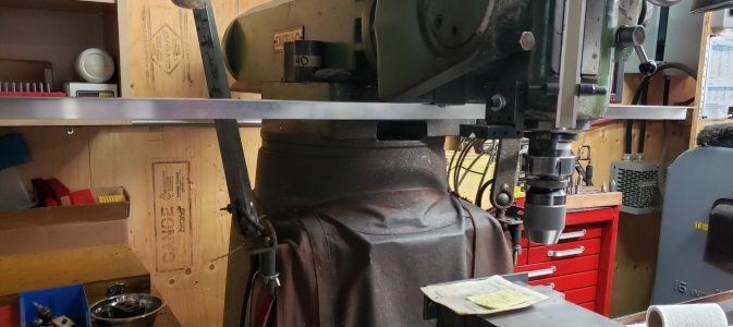

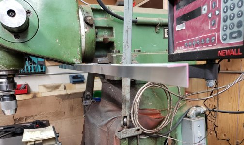

At the front side I’ve used a small pieces of sheet metal held in place with triangular welding magnets as swarf shields.

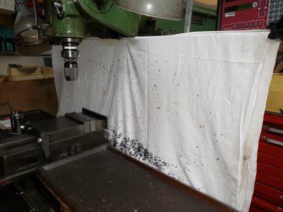

As you can see, the curtain concept works fairly well. Flying shards going rearward are pretty well contained. And the white material reflects quite a bit of light onto the work.
Of course, 1. Cotton sheets are not a good choice for the curtain material. 2. There are still lots of flying debris shooting towards the operator. This will take more time to design. Something quick and easy to set up and take down, and visibility and accessibility. One thing at a time.
Now to look for something white, flexible, heat resistant, and inexpensive. I like the vinyl coated fabric for upholstery idea, in white.

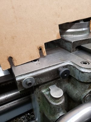

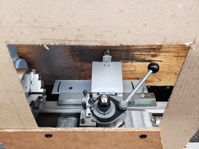

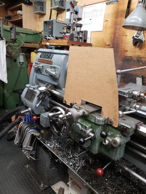

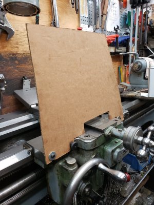

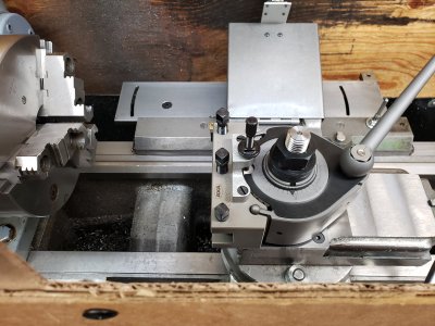

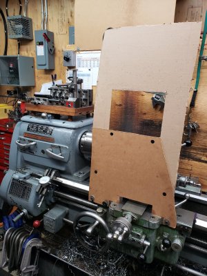

On a variation on the theme, this is an initial mock up for the lathe. Made out of cardboard for now, but I do have some AL5052 in 16g that might be perfect. The height, about chin height, and width seems fine, but I will put a clear lexan sheet above the height of the cardboard. It sits on 3 screws, but only the the knurled knob tightens it in place. Very quick to remove, and reattach.

I just added a piece. Pretend the opening is the lexan sheet. And the view is completely unobstructed. And I have access to all the controls. But to change tools, I will need to remove it.

Sorry a late reply, a plastic curtain is better (even if it melts), a cloth curtain (or fiber material, ie tarp) can catch a scarf shaving and if it is continuous can cause serious damage and or injury if snagged and grabs. As things go bad very quickly as the scarf is usually the last thing to give.

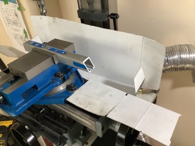

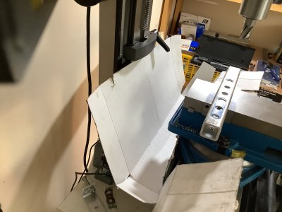

As mentioned by @Susquatch
Cardboard is a great way to guide your cuttings and chips to a disposal bin.
The glaze coated type clean-up easily and the chips slide away from areas.
I have been using folded cardboard for decades.
