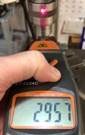

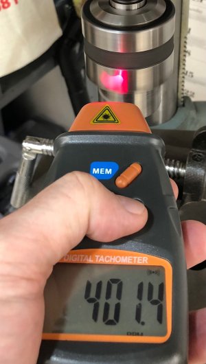

Over Christmas I started an unbelievably, incredibly, amazingly insightful thread where it was essentially pointed out that my drilling technique sucked. I received many helpful responses, but unfortunately it’s now lost to the great crash of Dec 2022.
One outstanding item was that drill presses may not run at the advertised speed, which gave me an excuse to purchase yet another tool.
Unfortunately, my test results were right on the money so I cannot blame my drill drill press, so happily the issue sits firmly with my current lack of ability. Which I can fix. Probably.
I’ll report back on my next round of hole drilling how I made out.
400rpm test:
3000 rpm test:
(The above result was a bit finicky to take, it was either 2000, 3000 or 4000 depending on how close I held the meter)
I‘ve no idea how accurate the meter is, for less than $30 it’s amazing.

I've got the same meter, and its readings seem to tally with the predicted speeds on a couple of my machines, also match the RPMs from the tach I installed on my drill press. As you say, an amazing tool. Almost as nifty as those temperature reading 'guns'. :) BTW, for shiny spindles, I've had good luck with a wrap of black electrical tape, with a strip cut out - less hassle than digging out the reflective tape.

@DPittman - I go one step further and use a wrap of black tape and then ALSO a strip of reflective tape. I have two rpm meters. A PA one that was practically free and an Amazon one that wasn't. They are both GFS without the tape. Distance from the tape also matters.
Another tip is to setup two sets of strips one above the other (like two rings on a giant resistor). Make one reflective strip narrow and the other wide. Sometimes that helps with speed jitter. On rare occasions I've had to use two strips and divide by two for really low speeds.
