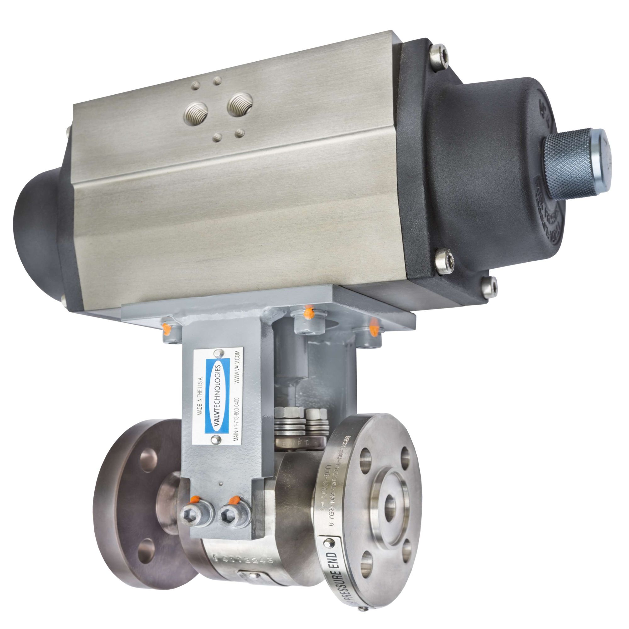

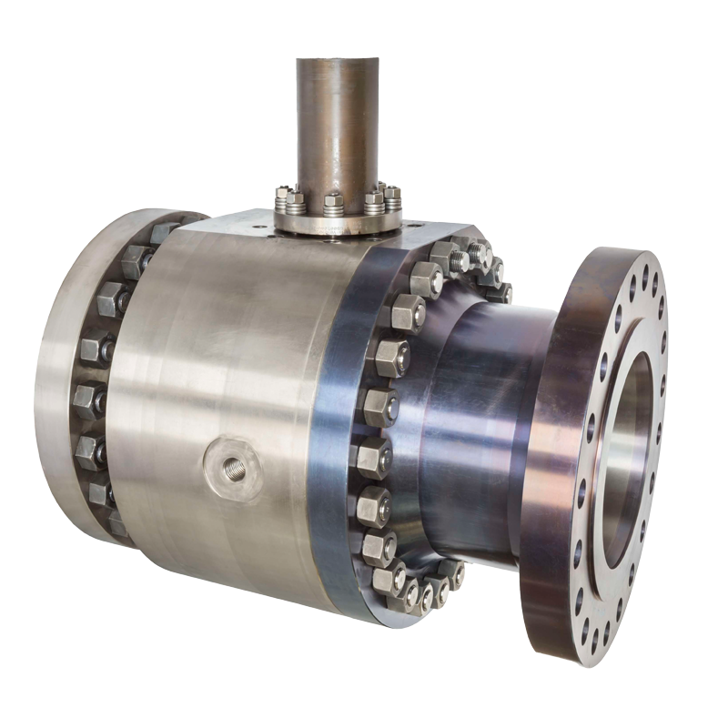

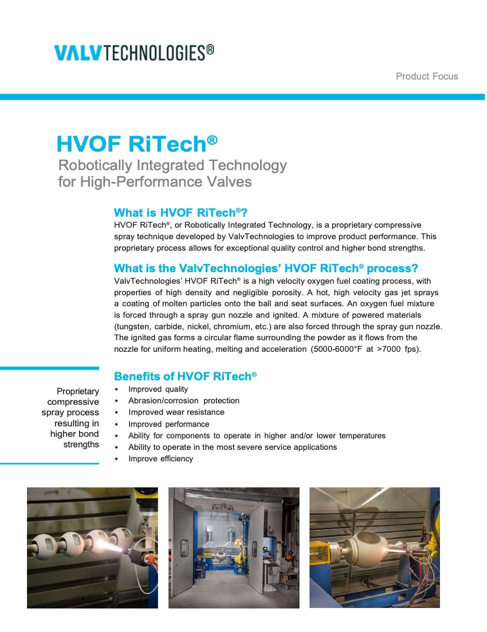

My business partners makes high pressure, high temperature, high abrasion, high corrosion valves for mineral processing. 2500 PSI, 750* F, pH 3, 30% solids. Nickel processing autoclaves. Our valve seats are typically HVOF chromium carbide overlays on alloy substrates.
If someone came to us and described this application, we’d probably look at Hastelloy C276 or C2000, Ferralium, AL6XN substrate and then we’d be considering different overlay materials
Be interesting to see what valv.com engineers could develop for this application.
Bragging - pulp mill in BC historically used Stellite-seated valves as steam isolation for blowdown at the bottom of their power boilers. They replaced the Stellite valves at every full mill outage, a new valve every year, sometimes more often if the valve failed prematurely. They bought a test valv.com valve in 1998. Sold them their first valv.com replacement last June. Lasted 23 years.
