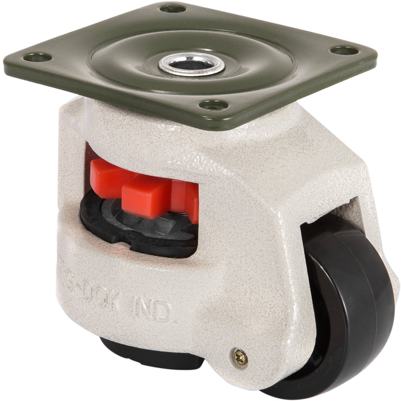

Kitchen cabinet toe-kicks are typically 3 1/2" to 4" high, and 3" deep. You will want more clearance when wearing safety boots.
Will you rap your knuckles on the handles with the bench top protruding past the edge of the chip tray? Is there sufficient room behind the mill for all guards to fully open?

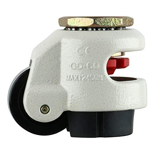

I just received these levelling casters that might work for you too; they could be centred under your corner posts. The mount and levelling posts are adequate for my 10x22 lathe, but the nylon wheel does not have bearings and might not be durable for frequent moves.
Vevor has a similar product with a different mount.
g'luck!
Not sure if you were planning to make or buy the feet. Most of the ones I've seen have basically a threaded rod with washers & nuts on either side that serve to both jack adjust & secure.
ie. so allow yourself enough room, big rod = big washer. The screw jack from top looks like a good idea, but you probably still want nuts either side of the plate to keep it put.
I'm fond of the rubberized feet myself, they seem to help dampen vibration & conform to floor surfaces.
The mill and stand will be close to 1000lbs, so I’m going to stick with non-caster feet. I do have plans to make up a set of “machine skates” that I can use for the Lathe, Mill and workbench when I need to move them” That’s why the side bottom support is flush with the bottom, so I can use a pry bar to lift up the Mill to insert the skates.

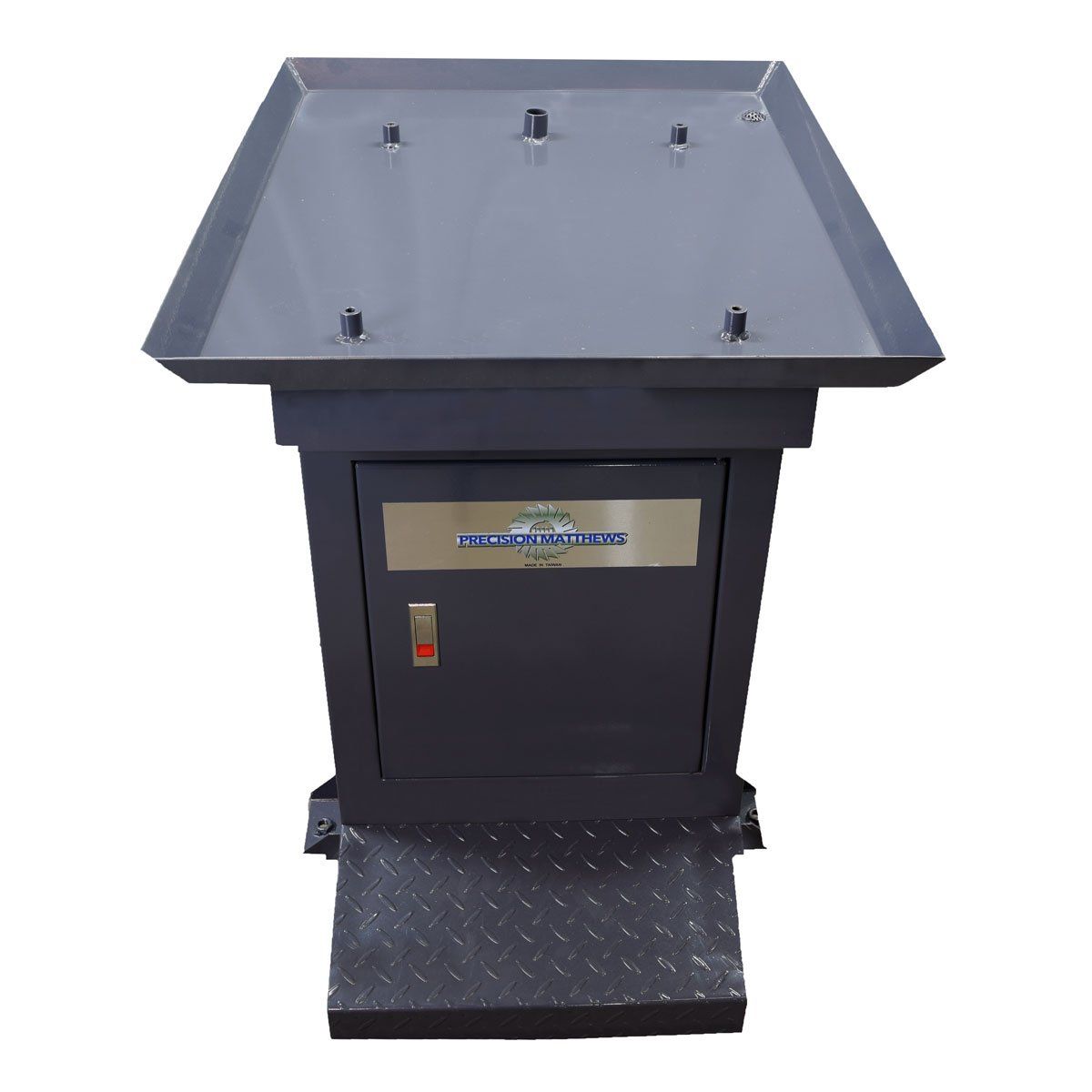

I checked your earlier thread--I'd forgotten that this mill is 750 pounds! Nonetheless, your design looks plenty sturdy to me.
Re ballast, I don't think that is necessary. Comparing your design to the stand Precision Mathhews supplies, your feet are placed considerably wider. Here is the PM stand:
And the protruding 'foot rest' looks like a disaster, to me! I don't see why they include it. It doesn't look to me like there is a front-to-back tipping hazard.
When I saw the PM stand, that spurred my to make my own. I don’t want to make a stand, but it it seemed like it the PM offering was “less than ideal”…
