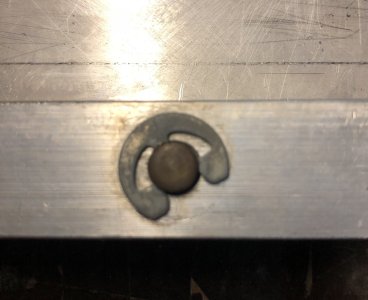

I have come across this washer—not sure what to call it—which is securing a peg that joins two plates of metal in a parallel plain. Both the peg and washer swivel, but the washer has a central tab that seems to be sitting in a channel that goes around the circumference of the peg. I’d like to remove the washer to separate the plates of metal. Is it possible to remove this washer? If so, how? And if it is removed, can the washer be reused or would removal damage it? Thanks for any help.

They are meant to be removed and reused.
You can also remove them with a small flat screwdriver in either one of the two open slots and then turn the blade to lever them off. Sometimes I also use a pair of flat nosed pliers to push on the two ends and the post to push the clip off or at least get it started so you can pull it off or wedge it off.
Another tip to help with the space launch mishap.
Those clips are spring steel. They are very hard. You can sometimes use a very small pair of vice grips to gently hold the clip while you remove it so it doesn't launch itself across the shop.

An appropriate sized flat bladed screwdriver inserted in one of the openings and twisted will pry it lose. There will be a small window of opportunity to pry it open just enough that you can finish with your finger or needle nose pliers and retain the clip, but if you go too far it will spring into another dimension never to be seen again. May luck forever be on your side.
Slip joint pliers work at getting those small ones off too, just hook one jaw over the shaft, and the other over the open end and squeeze. You should then be able to angle the pliers "just so" you can then grab the clip and wiggle it free. Depends on the shaft size, but that one should be doable.

These things seem to go by various names. BoltsPlus calls them "E-CLIPS" which is part of the Retaining Ring category:

I have found the holding a cloth or glove over the clip does a good job of 'retaining' these retaining clips as you pry them off. I'm sure that there is a proper tool, but whenever I have done it, I have used a slot screw driver

I do the same with the rag, but I usually use a chainsaw bar wrench rather than a screwdriver. I find the tee handle gives me a little better control over its release....

Most all of the e-clips/circlips etc. are referred to as f$$en clips after they leave for another dimension, never to be seen again, unless it's a big one, which still will be hard to find. And yes cover with a rag, glove etc. and put the safety glasses on. Yes, spares do lessen the likelihood of them migrating.

Like everyone said, carefully slide them to the side, out of the groove on the pin and put something over them to restrict how far they fly. Oh, and in case you're wondering, they're also used for hearing tests. If you can track where they bounce along their trajectory your hearing is pretty good!
Sliding them back on is a snap in comparison, pull them in with a pair of pliers or just push them in place with something like a wide screwdriver. The same advice about flying E-clips still applies! Maybe a wad of masking duct tape is worth a try.
