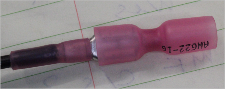

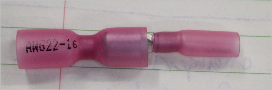

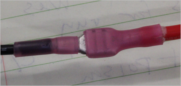

I bought a handy dandy crimp kit with various terminals. The heat shrink seems quite good, reasonably thick, has a adhesive that activates when shrunk. Supposedly weather proof or whatever the advertisement said. And I'm happy with the crimp aspect. Mostly I've been using ring terminals but I needed to do make a spade connection. You can see the open gap of exposed metal where the electrons will leak out on the floor. First I thought it was a dud or maybe I over-shrunk. But (lower picture) this is what they look like just engaged. I think the shrink on the male spade should extend further. I cant pull the shrink any further because they neck it down in the middle crimp zone. Is this just bad QC or are they generically like this?

You have the correct female spade but not the insulated male. The insulated male actually goes all the way around the female. So you have half of the correct set. It’s very common in the more cost effective sets to have that issue. You can see the correct ones in the stakon catalog. Page B38, https://tnb.ca/en/pdf-catalogues/wire-termination/termination-products/B-Terminals_Products.pdf

I see. But if the male also has shrink, wouldn't they become permanently fused once heat shrunk? Or maybe these are not really intended to be plugged & unplugged which I assumed was the whole point?

If I had to do what you are doing, I'd prolly cut the supplied shrink off, install a new one that would cover both sides, make the connection and then shrink the new tube onto the connected fitting. If I ever had to take it apart, I'd cut the shrink off, and replace it when I reconnected.

Not sure if you are replying to me but these particular ones are most definitely heat shrink. That aspect is actually remarkably good. The material is 3x the thickness of regular heat shrink tubing & have an adhesive that gets activated like you typically see on tougher duty heat shrink. But because the shrink segment is pre-installed for convenience & cant be slipped down to adjust position, it doesn't leave me any options specifically on the spade connector.
It might be a QC issue on my kit. When I look at others it shows more shrink overhang on the female. So maybe the intent is engage them, heat the shrink (on both as an assembly) & it would make a more permanent overlap seal? If that's the case I don't think that lends itself to unplugging/re-plugging down the road. The shrink would probably distort or rip on the adhesive. This isn't anything mission critical, more of a general question.

On the stakon ones only the wire insulation end is shrinkable. You can see the line where the heat shrink ends. The connection ends don't shrink unless you really hit them with the heat gun, which is not what you want. I switched over to using Deutsch style connectors and weather pack years ago. As they do not have the pull apart issues and they are weather and corrosion resistant. I still use lots of stakon style ones but rarely for inline connections. Most of the spades are used for connections directly to switches or relays. In a pinch for the RV I have the solder shrink style butt connectors that is more in the woods repair. Having said that I have solder shrink ones that have lasted more then a decade on my flat deck.
