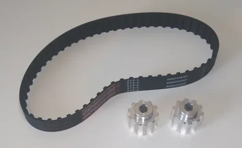

Along the same thread has anyone ever seen any cutters for XL or L series pulleys?
I have not. From a quick search, I wonder if it could be cut with a three step process: first a flat bottom pass, then one each for the 25* flanks? Would take three times around in the dividing head, but could be done. This is using a straight sided cutter.
A special single lip cutter could be ground as well. Then, used as a fly cutter, could generate the required profile.
Or, Alibaba seems to sell timing belt pulley hobs…

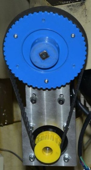

The problem is the HOB for an L series pulley is, with shipping about $175. These are the only ones I need. I may just start with 3D printing them and maybe make a metal hub. They are for the AR4 robot arm.
I have done that before with reasonable results but I'd rather do it in metal since the plastic hub part holding the set screws and keys are usually the weak point.
The yellow plastic pulley ultimately failed.
I would think a 3d printed gear profile bonded to a metal hub should give you the strength you are looking for.
