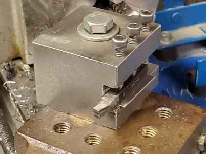

@Mcgyver, that looks very much like an 011 size. They are officially 32.5mm tip to back and 17.9mm high. I would greatly appreciate either dimensions of the internals, esp. the cam offset. Or I could pick it up from you, do the drawings/CAD and return it.
For those who don't know about Tripan, they have sizes from 011, 11 and 111 (and up.) 011 is great for watchmaker lathes such as Boley and Lorch. Mine when built is for my Sherline, might need a small riser block. The 111 is suitable for 9-10" lathes. Catalog is here: (I am not responsible for damage to your bank account) https://tripan.ch/wp-content/uploads/2021/08/CATALOGUE_TRIPAN_2021_FR.pdf

I've built a miniaturized version to work on 8mm lathes. Was going to do it as an article in the mag (THE mag lol, Home Shop Machinist). imo that addresses a huge problem.... I mean what is there out there in WW QCTP? There is little need for watchmakers I guess, almost all work is done with gravers by hand, but for us machinist types ...... I can barely get near a lathe without a QCTP! bunch of photos here https://canadianhobbymetalworkers.com/threads/an-adventure-in-lost-resin-casting.9140/#post-134672
There are just two internal parts, the plunger and the eccentric lock. I don't have photos yet but will try and get some together.
I do have one the smallest size Tripans, whatever number that is, I could pull measurements off it if that is what you are after.
I remember that thread. Downsizing those to fit on my Unimat would make life with it much nicer.

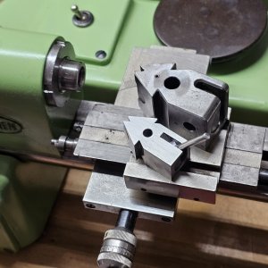

I was wrong on this, started checking dimensions. The Tripan I have is an 11 not a 011. Perfect for a Schuablin but too big for WW. I can see how the 011 would be perfect for a watchmakers lathe.
Mine is 5/8 tall, so slightly smaller than a 011 but not by much.
The TP would be 400+ after shipping and tax, and what is worse is the holders - $200 each shipped & taxed. And what is the point of a QCTP without a lot of holders! Too rich for me. (I think Europe would be the place to live, but only if fabulously wealthy lol)
The holders are easy to make if a bit tedious in volume. You do have to be quite careful with the dovetail; in this size the throw of the eccentric is so small you want to start with a close fit of the holder on the body
Comparing mine to the 11.
Awesome to see these together. What is the throw of cam on your 011-like version? The rest kind of falls into place with what we know.
