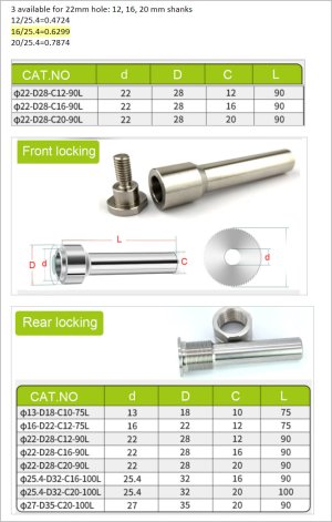

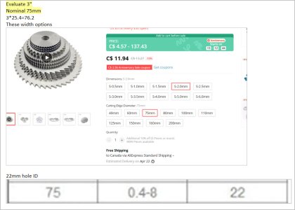

@David_R8 coincidentally I just ordered these from Ali, so should be in a position to tell you about quality when they arrive pretty soon. All they sell is metric saw widths but I'm OK with that. Actually for my (metric based) radial engine it caused me more grief to figure out new dimensions for IMP saws for cooling fins & such. I opted to try the 75mm OD blades & bought the appropriate arbor.

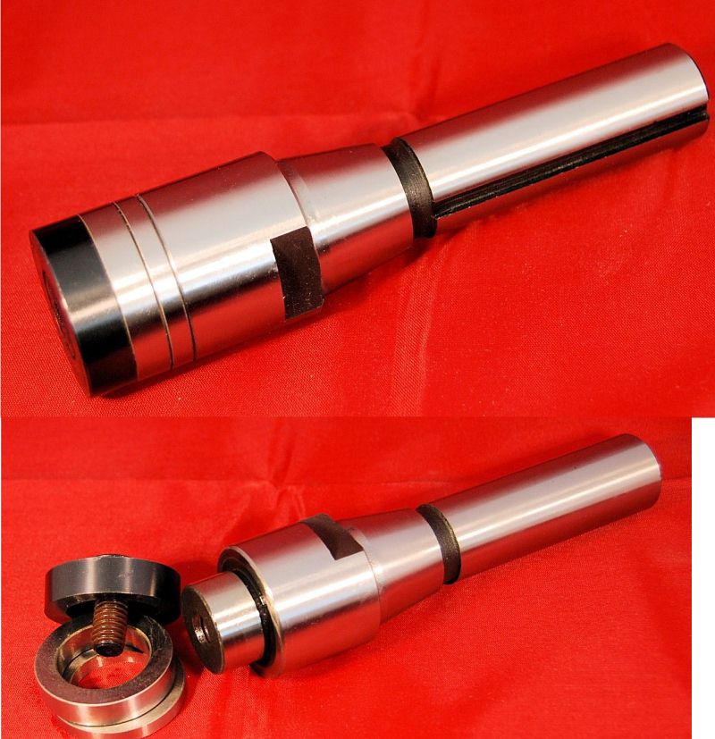

I've bought a few blades onsey-twosey as I've needed them predominantly from KBC in the past. But I started to get generally frustrated by the N-Am offerings. The blades vary in quality. The Euro ones have been fine but they come in certain dimensions that you need specific arbors. Then the shanks vary so you have to have the right collet or holder to marry to the mill. I've also had some made in India saws that I'm pretty sure were the tops of soup cans. They wobble like crazy even when the arbor is perfect fit. You can find some super duper USA arbors with low runout but they are crazy prices. Maybe used for CNC not sure. I was just preparing myself to make my own arbors because I'm confident I can replicate the accuracy (but not hardened/ground). So that's what got me looking at Ali. Fingers crossed. I have HSS coming but in other suppliers I see carbide for the price of HSS domestically. Your application may vary but I find small diameters might be limited in what they can cut. By the time you factor the appropriate holder, you may not have much actual saw depth. The Ali link offerred a few different flaours once you cross reference the saws, hole ID's, available arbor options etc.

Thanks Peter, do you have a link to the arbor?
One thing I seemed to stumble on more often than not with the typical domestic arbors, the vertical distance from the saw to the bottom of spindle barrel is quite short. So many things I held in a vise did not play play well together. What I'm saying is it would be nicer to have an extended shaft ad larger diameter cutter. There are probably practical limitations but I liked the length of the Ali vs what I have. the smaller diameter saws use proportionately smaller arbors & that's fine, likely smaller parts in that case.
Link to homebrew arbor. Note the bigger saws typically require keys
