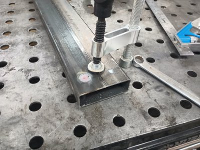

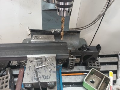

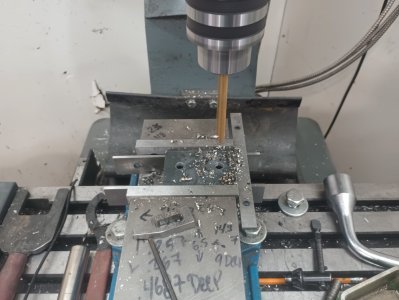

Why not use the mill/drill for all the holes, i chose a symmetrical pattern so that i wouldn't have to lay anything out, set up a stop and use the dro, just need to flip the parts around for the various holes

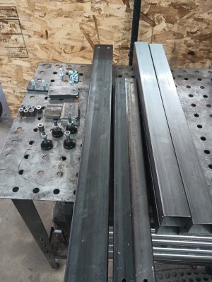

Parts all cut up and laid out, the tubing is 2x2x.065 and 1x3x.065

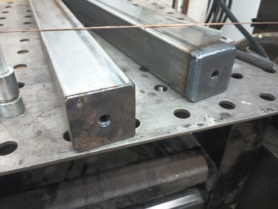

nuts welded on to the end caps for the use of levelling feet if so desired, and caps welded to the end of the tube

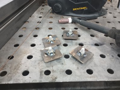

welding slugs in so that i dont crush the tubing when tightening things down, and welding the back side of the 'fakers'

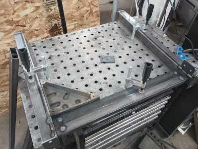

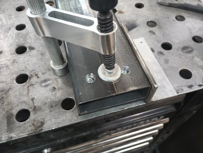

The budget princess auto fixture table in action, with the cheap-o clamps it comes with

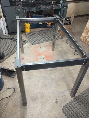

Test fitting before powder coatings

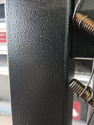

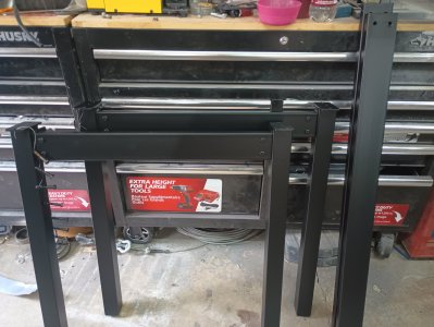

The powder i had must have been contaminated, every piece fish eyed like crazy....only saving grace is that its so consistently fish eyed it looks intentional...wife actually likes it....so i guess it stays like this

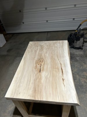

And the slab, before epoxy, it is actually ready to be picked up, but its raining, so it will wait for another day
I don't know if it qualifies as gigantic, inside it measures 2x3x4'-4", and you loose some on either side for the elements
it actually used to be 2ft taller, but I didn't need that height anymore, and it took much longer to pre-hea+ moved it to a spot with less headroom
I still did have to do the 2 welded leg sections separately, you cant pack things in as tight as you might think, it's pretty easy to swipe off the powder loading things in

Ha, now i just need to turn one into a "happy little tree" and i would be making good ol bob ross proud!
